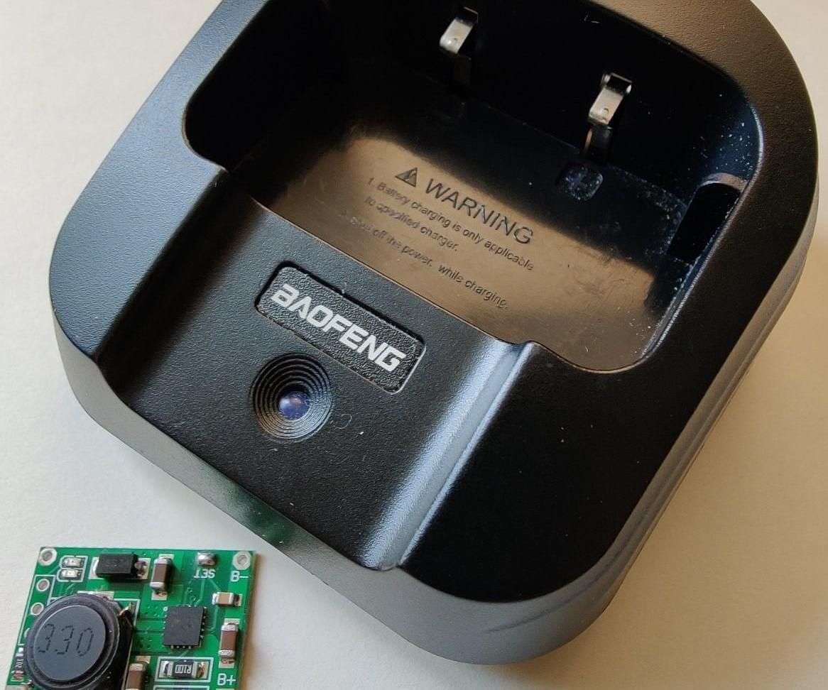

Step 1: Step Up a Boost Module Output Voltage
The output of the boost module to be connected directly to the input of the charger in this twick. That requires some kind of protection, so that the boost module is not burned out when the stock power supply is connected.
Architecture of the boost module uses a Schottky diode D at the output (see the picture above). In fact, the diode would also serve as a protection diode for the module, so that you can use the charger as usual with its stock power supply. However, for the diode to serve as a protection, Vout of the boost module should be a bit lower than the voltage of the regular power adapter, so that the diode is closed by the higher positive potential at its Cathode (comparing to its Anode) in case you connect both power sources at the same time.
Since the stock power supply delivers about +10V, I would suggest setting Vout of the boost module at +9.6…9.8V. It should not be lower, so that the charging chip can still operate correctly.
To do so in my particular case (I use 2149F boost module with preset Vout = 12V), I’ve replaced a 287k resistor with 220k (highlighted at the picture). You may simply tune the Vout by a potentiometer in case you use the other kind of boost module...

Step 3: Glue the Boost Module and Connect It to the Charger
Magically, the width of all boost modules I have is about 17.5 mm and they fit the available space inside the charger perfectly.
Fix the module with some hot glue and solder its input to the USB-C connector and its output right to the input of the charger as shown at pictures above.
Also, add a drop of the hot glue on the top of the Power LED to create kind of light guide lens.
Done! Looks like the USB-C connector has been always there!
