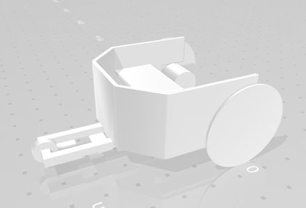

Step 4: Chariot Base
Arrange the two trapezoids and six 4" pieces into the above shape. Using the Hot Glue Gun, attach one 4" piece down the center, and two 3" pieces along the sides. This will form the base of the chariot.
Step 5: First Layer of the Wall
Grab three of the 2" pieces of Balsa Wood and two of the 1.5" pieces. Using the Glue Gun, attach the pieces to the Base (the 2" pieces will be vertical and horizontal, and the 1.5" pieces will be diagonal.)
Step 6: Second Layer
Using the same pieces, repeat the last step, making the Wall 1" tall.
Step 7: Wire Holes
Using the Wood Cutter (or a 3/8 drill bit if available) make holes in the base as shown in the attached picture. One hole is 2.5" in, and 0.5" up, while the other is 0.75" in and 2.75" up.
Step 8: Mounting Motors
Using your two 1.5V motors and the Hot Glue Gun, attach your two motors to the Base. Make sure to secure them with ample amounts of glue as these wheels are jostled quite frequently.
Step 9: Battering Down the Battery

Step 19: Front Axle
get the three 1.125" pieces (of the 36" x 0.5" x 0.125" Balsa Wood) and your bearing. Using the 24" x 0.25" x 0.25" Balsa wood, cut out:
  • 2, 3" pieces
  • 1, 0.75" piece
Put the bearing on the 0.75" piece, and glue on the two 3" pieces as shown above. Then, attach the three 1.125" pieces as shown. (Make sure there is a slight gap between the Balsa Wood and the bearing as this will cause friction. Balsa Wood should overhang slightly)
Step 20: Attaching the Axle
Flip the chariot over, and glue on the front axle as shown. The support piece running through the center of the axle should be above the center support on the base of the chariot. Make sure to keep it as straight as possible as any angle on it will cause it to turn in that direction.

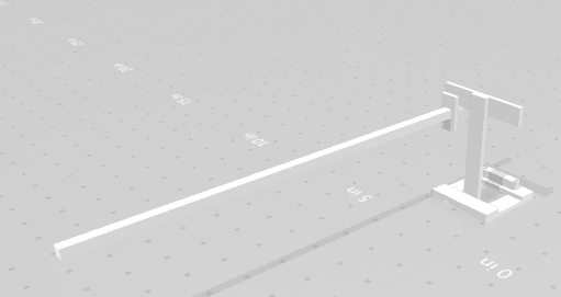

Step 25: Assemble the Base
Glue the four 2" pieces into a square. The final shape should be a 2" x 2" square with a 1" x 1" square in the center.
Step 26: Torso Section
Using the 3" piece and 2.5" piece, glue together a T-shaped structure, with the 3" piece being the Vertical section and the 2.5" piece being the Horizontal.
Step 27: Handmade
On the 1" piece, make a hole directly in the center that has about a 0.25" diameter.
Step 28: Assembly
Taking all the pieces, glue them together into the structure above.
Step 29: Weighing Down
Get 4 paperclips and masking tape. Tape the 4 paperclips together and then put a piece of masking tape on upside down so the sticky side is on the outside. Put this on the back of the Rider to create weight.
NOTE: Depending on type of paperclips used, more may be needed to weigh it down.
Step 30: Jousting Rod
Using the 12" length of Balsa Wood and the edge of a table, roll 1.5" of it into a slightly spherical shape.
Step 31: Finishing Up the Rider
Slide the spherical end of the 12" piece into the hole on the Rider. Place the Rider on the floorboard of the Chariot and you are finished!

Step 34: CAD Files
Here are the CAD files for the Chariot and Rider. These are just basic models to give a better understanding of the Structures needed to be built.
