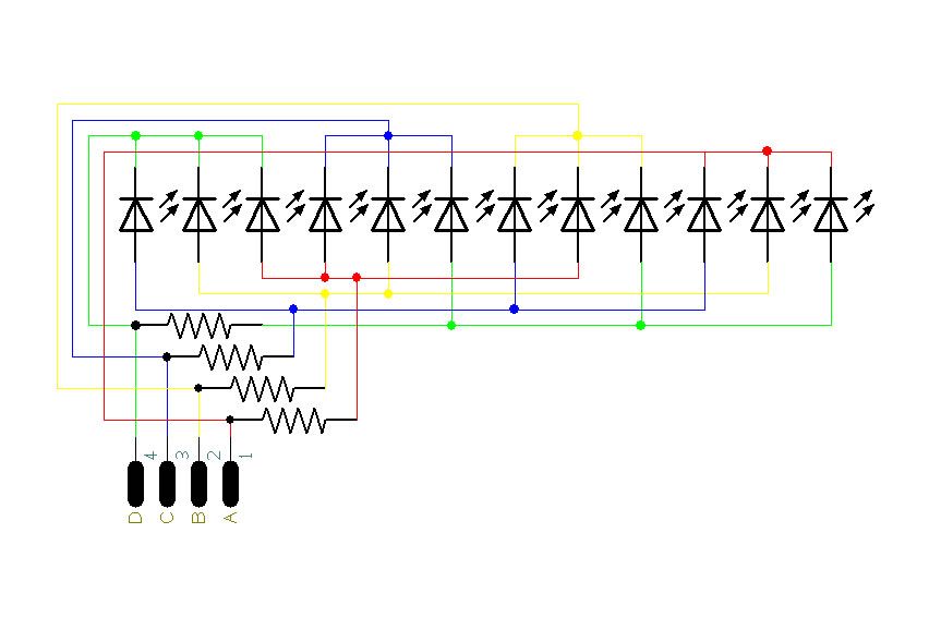

    Found this to be a very useful instructable, although I found the diagram a little hard to follow. I had a crack at a version myself and came up with the following. I've colour coded the pin outs which has helped me with visualising
    Charlieplexing.
    My plan is to have play with the code to see if I can improve the bounce of the larson, and perhaps port it to an ATTiny rather than monopolising an Arduino!
    Great instructable by the way. Having a look at your new ones now!

    Your schematic is backward from the instructable. You have pin 1 going to LED1, LED2, LED3 and the instructable has pin 4 going to LED1, LED2, LED3. Pin 2, pin 3 and pin 4 of the Arduino are also flipped (i.e. 1 to 4, 2 to 3, 3 to 2, and 4 to 1).
    Additionally, you both use pin 1, 2, 3, 4 in your schematic and then use 0, 1, 2, 3 in the code.
    Lastly, neither of these schematic allow the program to work in all three modes.
    Am I missing something or was this just a very poor example of charlieplexing. It is complicated enough without getting contradicting info.

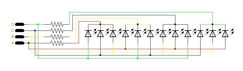

    The schematic you've commented on and the instructable have different authors, hence the differences. I went away to try to get my head around charlieplexing and that's what I came up with independently and as it helped me understand the concept, so I thought I'd share it. It was my first attempt and I've improved it since. With the new one below. The pins are labelled ABCD in this version...
    The instructable is a really good example of charlieplexing and helped me a lot. It's not the only resource I used to understand the concept.
