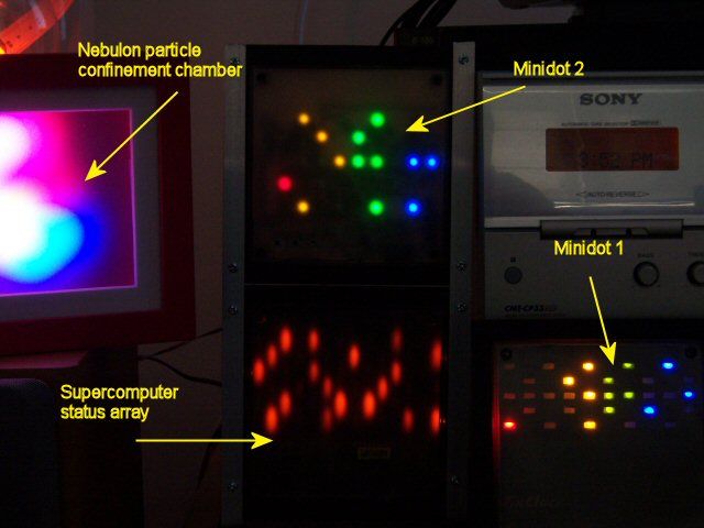

And a couple of my own projects,
The Microdot watch:- https://www.instructables.com/id/EWM2OIT78OERWHR38Z/
The Minidot 2 clock:- https://www.instructables.com/id/E11GKKELKAEZ7BFZAK/

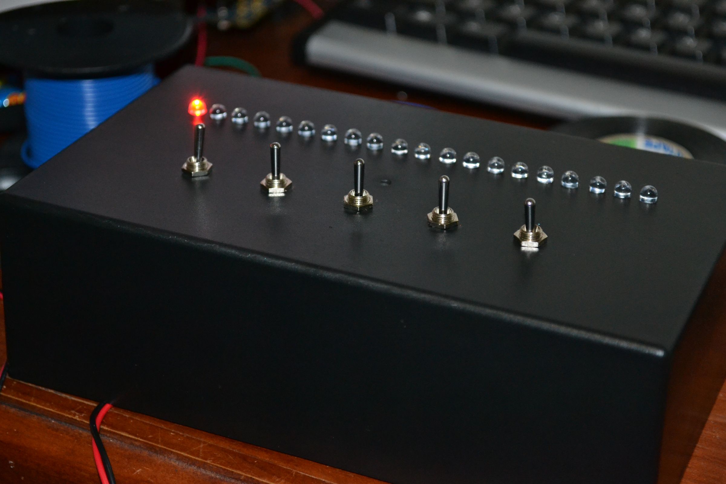

    Simply an excellent article. Can you confirm that we cannot turn on all LED's in the matrix at the same time using this method? Thanks.
    0
    rgbphil
    rgbphil
    Reply 9 years ago on Step 7
    You should only keep one LED on at a time if you have no buffering on your micro, or else the current draw will exceed the micro design tolerances.
    However if you read the front page, there is quite a thread on lighting several LEDs at once with a charlie matrix. It is possible, but you should really buffer the control lines.
    Check out the comments on this and follow the links back to the bloke who put me right in this regard.....he's got some great examples of more advanced charliplexing on his pages and probably a better explanation than I could have done.
