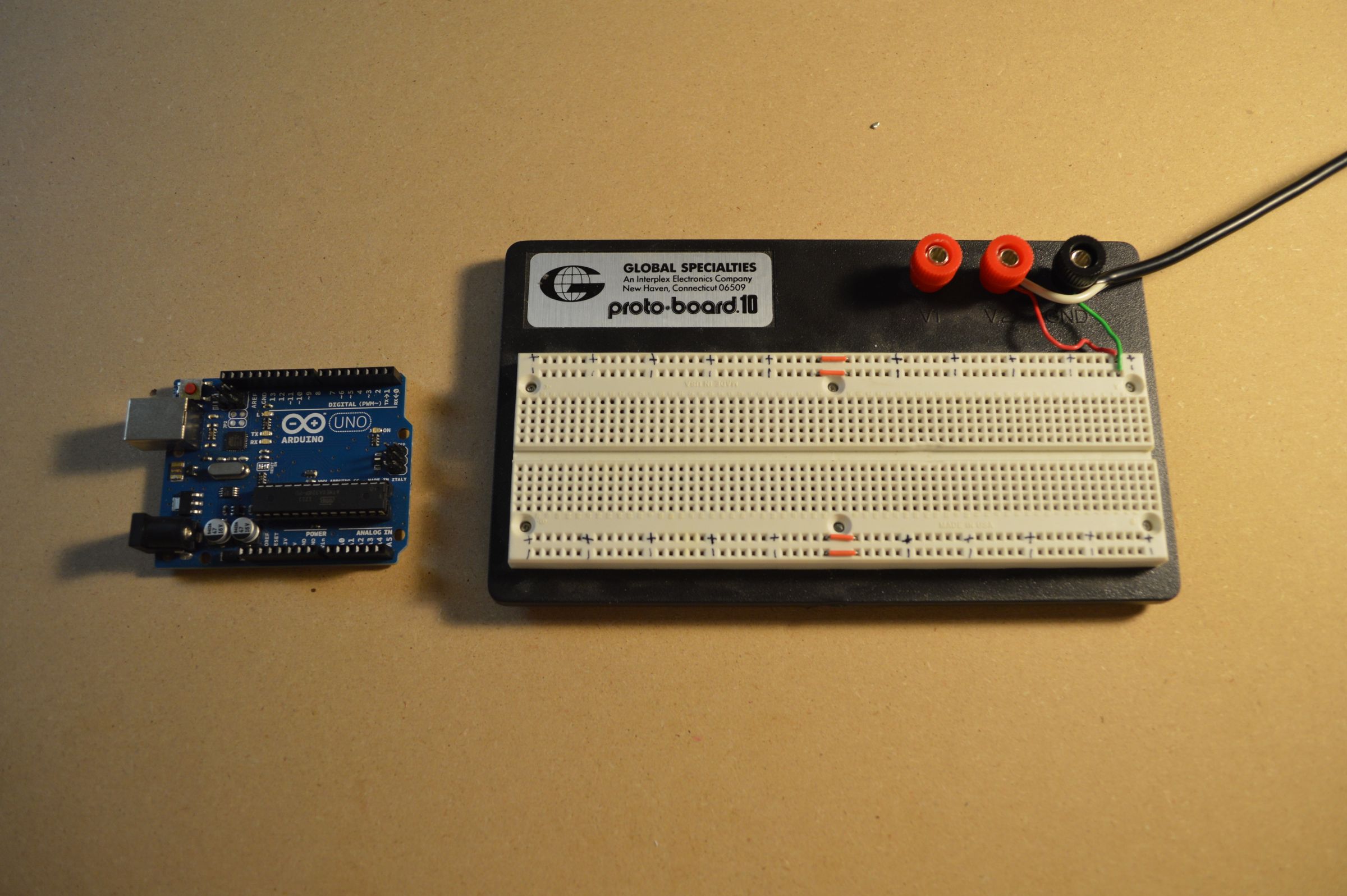

Step 2: Configure Hardware
Connect two LEDs to each Pin; be sure to flip the LED so the Cathode (+) and Anode (-) are on the correct Pins. The cathode (+) has the longer leg and is shown in the schematic as the leg with the bend in it.
