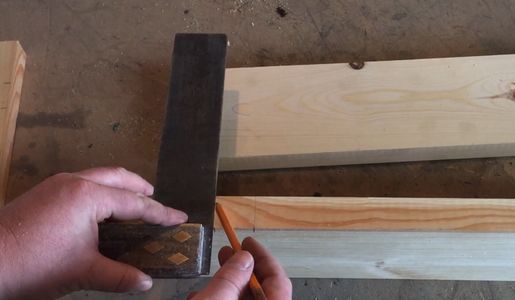

Step 6: Marking for Dowels.
Using a square I transferred all the lines to the side of the wood.
