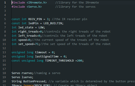

Step 3: Programming
The following code is the core of Chase's functionality. It consists of four main parts:
- Libraries: The code imports two libraries: IRremote.h, which handles the input from the IR remote, and Servo.h, which controls the servos that move the treads and the LED.
- Variables: The code defines several variables to store the robot's state, such as the tread speed, the LED state, and the last remote button pressed.
- Setup: The code initializes the servos and attaches them to their pins. It also enables the IR receiver to listen for signals from the remote.
- Loop: The code runs in a loop that checks for signals from the remote. Depending on the signal value, it sets the tread direction and speed. If no signal is received for a certain amount of time, it stops the treads.
- Reset and Execute: The code has two custom functions: reset(), which stops the treads, and execute(), which updates the servo positions and toggles the LED state every 500 milliseconds to prevent the battery from shutting off.
This is a brief overview of the code. For more details, please ask me in the comments section.
To use this code, download it and upload it to your Arduino nano.
This is the programming for Chase.
#include <IRremote.h>     //library for the IRremote
#include <Servo.h>        //library for the servos
const int RECV_PIN = 3; //the IR receiver pin
const int ledPin = LED_BUILTIN;
int led_state = LOW;
int right_treads=0;//controls the right treads of the robot
int left_treads=0;//controls the left treads of the robot
int speed=0;//the current speed of the treads of the robot
int set_speed=75;//the set speed of the treads of the robot
unsigned long timeout = 0;
unsigned long lastSignalTime = 0;
const unsigned long TIMEOUT_THRESHOLD =200;
Servo rservo;//naming a servo
Servo lservo;
String ButtonPressed; //a variable which is determined by the button pressed on the IR remote
IRrecv irrecv(RECV_PIN); // Create an IRrecv object
decode_results results; // Create a decode_results object
void setup() {
  lservo.attach(5);//sets the pin number for the servo
  rservo.attach(6);
  lservo.write(90);//tells the servo to stop
  rservo.write(90);
  Serial.begin(9600);//begins the serial monitor
  irrecv.enableIRIn();//a function that prepares the Ir sensor
  pinMode(ledPin, OUTPUT);
void loop() {
  if (irrecv.decode(&results)) {
    if (String(results.value, HEX) != "ffffffff"){ButtonPressed=String(results.value,HEX);}
//These control what happens depending on the button pushed on the remote
//to control left_treads/right_treads make it equal "1" or "-1",  1=clockwise  -1=counter-clockwise
    if(ButtonPressed=="ffa25d"){}
    if(ButtonPressed=="ff629d"){left_treads=-1;right_treads=1;}
    if(ButtonPressed=="ffe21d"){}
    if(ButtonPressed=="ff22dd"){left_treads=1;right_treads=1;}
    if(ButtonPressed=="ff02fd"){}
    if(ButtonPressed=="ffc23d"){left_treads=-1;right_treads=-1;}
    if(ButtonPressed=="ffe01f"){}
    if(ButtonPressed=="ffa857"){left_treads=1;right_treads=-1;}
    if(ButtonPressed=="ff906f"){}
    if(ButtonPressed=="ff6897"){}
    if(ButtonPressed=="ff9867"){}
    if(ButtonPressed=="ffb04f"){}
    if(ButtonPressed=="ff18e7"){}
    if(ButtonPressed=="ff7a85"){}
    if(ButtonPressed=="ff10ef"){}
    if(ButtonPressed=="ff38c7"){}
    if(ButtonPressed=="ff5aa5"){}
    if(ButtonPressed=="ff4ab5"){}
    irrecv.resume();//prepares Ir sensor for new results
    lastSignalTime = millis();
  timeout = millis() - lastSignalTime;
  //Serial.println (left_treads);
  execute();
  if (timeout > TIMEOUT_THRESHOLD) {
    reset();
  else{
    speed = set_speed;
void reset(){
  //ButtonPressed="0";
  left_treads=0;
  right_treads=0;
void execute(){
  lservo.write(90-(left_treads*(speed)));
  rservo.write(90-(right_treads*(speed)));
  Serial.println (ButtonPressed);
  if (millis()%500==0){if (led_state==LOW){led_state=HIGH;}else{led_state=LOW;}}
  digitalWrite(ledPin,led_state);
