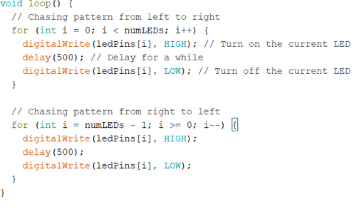

Step 4: Write the Arduino Code
Used the following sample code to create a basic chasing pattern:
const int numLEDs = 13; // Number of LEDs
int ledPins[] = {0,1,2, 3, 4, 5,6,7,8,9,10,11,12}; // Pins connected to LEDs
void setup() {
for (int i = 0; i < numLEDs; i++) {
pinMode(ledPins[i], OUTPUT); // Set LED pins as output
void loop() {
// Chasing pattern from left to right
digitalWrite(ledPins[i], HIGH); // Turn on the current LED
delay(500); // Delay for a while
digitalWrite(ledPins[i], LOW); // Turn off the current LED
// Chasing pattern from right to left
for (int i = numLEDs - 1; i >= 0; i--) {
delay(500);
