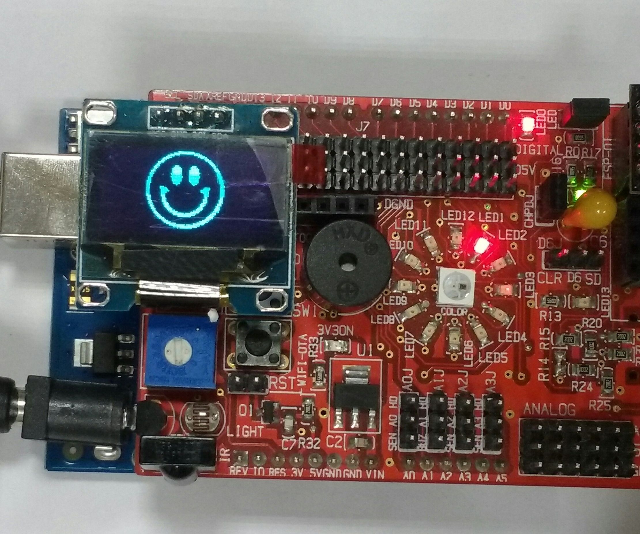

In this example, we are using NRF24L01 radio module and Arduino to communicate to the other Arduino and Nrf24L01 radio module using the serial monitor.
Here we are creating a local mesh between two radio modules(Nrf24L01). The two sets of Arduino and nRF24L01 are connected together to establish a wireless Serial communication link so that they could talk to each other. The nRF24L01 are half duplex transceiver modules, hence they can send and receive data. The data is sent from the user using Arduino Serial monitor, by typing on his keyboard, and this data can be received and displayed on the receivers OLED display, which is on the Idiotware shield, and vice- a verse. This project is limited to just adding two members to the Chat room, But the nRF24L01 has capability to handle 6 connections, and so there could be a maximum of 6 members in our chat room, each talking or chatting with each other. This chat room coverage could be upto 100 meters depending upon the nRF24L01 Modules range.

Connect the NRF module to NRF24L01 header
Step 4: Connect OLED
Connect i2c OLED on the headers above the touchpad
Step 5: Connect Buzzer
Connect the BUZ pin to the center pin on SEL13 pin header, effectively connecting the Buzzer to the A1 pin.
Step 6: Upload the Code
Upload the code from Arduino ide and start chatting with friends in neighbourhood.Use the Serial monitor of arduino ide to send message.
