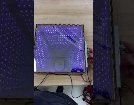

Step 4: Build the Box
The attached .svg file will work to build the box using a laser cutter and 1/8-inch acrylic.
I cut out holes where appropriate for the screen, buttons, and power cable. I left the box half-assembled for some last testing to verify that my code was working properly. With some of the panels still removed, I soldered each part to my Pico W for a more permanent connection.
Next, I used superglue to attach the speaker, lights, pico/breadboard, screen, and buttons. Then I assembled the box, applying superglue in the joints to hold everything together. I avoided supergluing the top of the container so that I could remove it later if needed.
Enjoy your final product!
