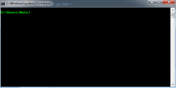

Step 4: Try Them Out!!! :)
Now just open both programs, type in your name, and say something. Boom! You just made a chat program. Now all you have to do to chat with others is share the folder with them!
