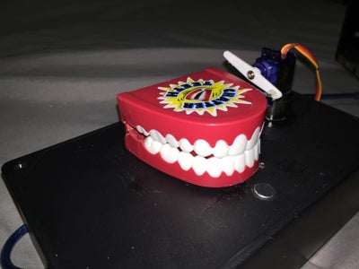

Step 5: Assembly
The second image is from after I glued the 1 inch hinge to the back of the the teeth. This hinge is a crucial part and is best installed first! The teeth must be removed from their original hinges and insides sanded out.
*Note: It is very important that the bottom layer of teeth and the servo are both securely mounted before running the sketch. Not doing so could cause your servo or your glued connections to break.

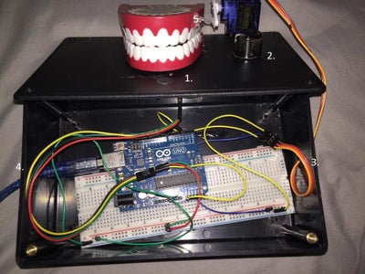

Modifications to the black Arduino box:
- Two holes drilled and reamed out until large enough to accommodate the USB cable and the servo wires on both of the short sides of the box. (3 & 4)
- An additional hole was drilled in center-edge of he lid in order to mount the microphone. (1)
Mounting:
I used hot glue to mount everything so I reuse parts and wires in future projects.
- Number 1 shows the microphone glued into place
- Number 2 shows my painted pvc end cap I used to mount my servo. Feel free to 3D model one, I just picked one up from a hardware store for only a few cents
- Number 5 shows the piano wire connecting the servo arm and the teeth. This is tricky with hot glue, I would recommend using another form of mounting such as an arm that screws in
