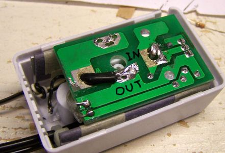

Step 14: Trim the 110V Wires, Reattach CdS Cell
Trim off the 110V wires and strip them about 3/16 inch so they will align with the pads where they will be soldered, marked IN and OUT in the photo. One pad is the place where the wire comes through, and the other where one of the internal 110V spring connector was removed. After you trim the wires to length it may be easier to pull the circuit board off temporarily to strip the wires. Tin the ends of the wires and bend them so they will lay flat over their pads. Trim them so they won't extend past the pads when they are soldered down.
At this point I reattached the CdS cell leads, circled in red. Why? For no reason I can remember, now that I'm trying to make these pictures into an Instructable. I attached the leads to the side of the board facing up. If the holes are clean you could try to get the wires back up from underneath but it's not necessary. It also doesn't matter which lead goes to which pad, CdS cells are not polarized.
Step 15: Solder the 110V Wires
Solder the 110V wires in place, making sure you don't create any shorts to other circuit board traces. Referring to the pictures, mark the IN and OUT pads on the board, and also mark the far end of the 110V wires so you'll know which is which when the box is closed.
If you tore a circuit trace removing one of the brass prongs back in step 5 (like I did on the second module) you can still attach the 110V wire as shown in the second picture. You just have to be neater about it and be sure you don't make a solder bridge to one of the neighboring traces.
