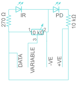

Step 4: Making the IR and Photodiode Sensor
It;s very easy to build IR sensor and it is lot cheaper than the ultrasonic sensor. If you cannot find this sensor, you can make it by your own. You can use ordinary IR and photodiode LEDs to make this circuit. The circuit diagram is shown, and the PCB layout file (if you want to make PCB for it) is given below. You have to remember that photodiode connects in reverse bias and at forward bias it works as a normal diode, so always connect it in reverse bias. 270Ω resistor is use to limit current for IR-LED and the 10kΩ resistor is used to limit the photodiode. potentiometer is used to vary the wavelength of LEDs by changing its voltage. The circuit uses +5V supply for is operation. more voltage can burn the circuit.
You can use blank pcb or copper clad board to make this. The pcb layout file and circuit diagram is given below.

Step 6: Connecting Proximity Sensors
Connect the proximity sensors as shown, and better if u place it over a cardboard or other material. check the sensors and change the resistance so that the range of all the sensors must be matched.
The connection of proximity sensors are very easy. We need to connect the data terminals to INPUT- of LM324 (please refer to datasheet for perfect understanding. Now we need to connect the variable resistor terminal to INPUT+ of LM324. The positive and negative terminals of proximity sensors are connected to the +5V supply. Always take care while inserting the leads into the breadboard as if it's not inserted properly, it won't work.
