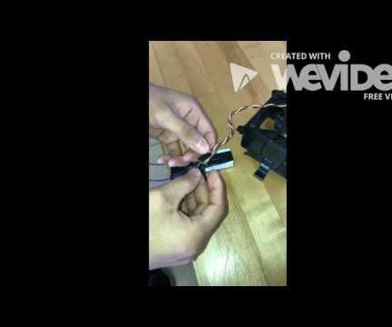

Step 3: Solder Copper Wires
The diagram explains the steps on soldering the wires and equipment together. The B stands for batteries and the R stands for a resistor. The diagram should be useful to connect everything together.
