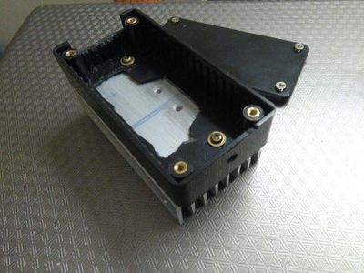

Step 1: The Enclosure
I cut the back out of an ABS enclosure so I could screw the chip onto the heatsink. As you can see the box is screwed straight onto the heatsink too.

I definitely could have done with a bigger case but I managed to squeeze it in anyways. Also there is thermal grease between the chip and the heatsink so it should last a good while before going thermonuclear ;)
