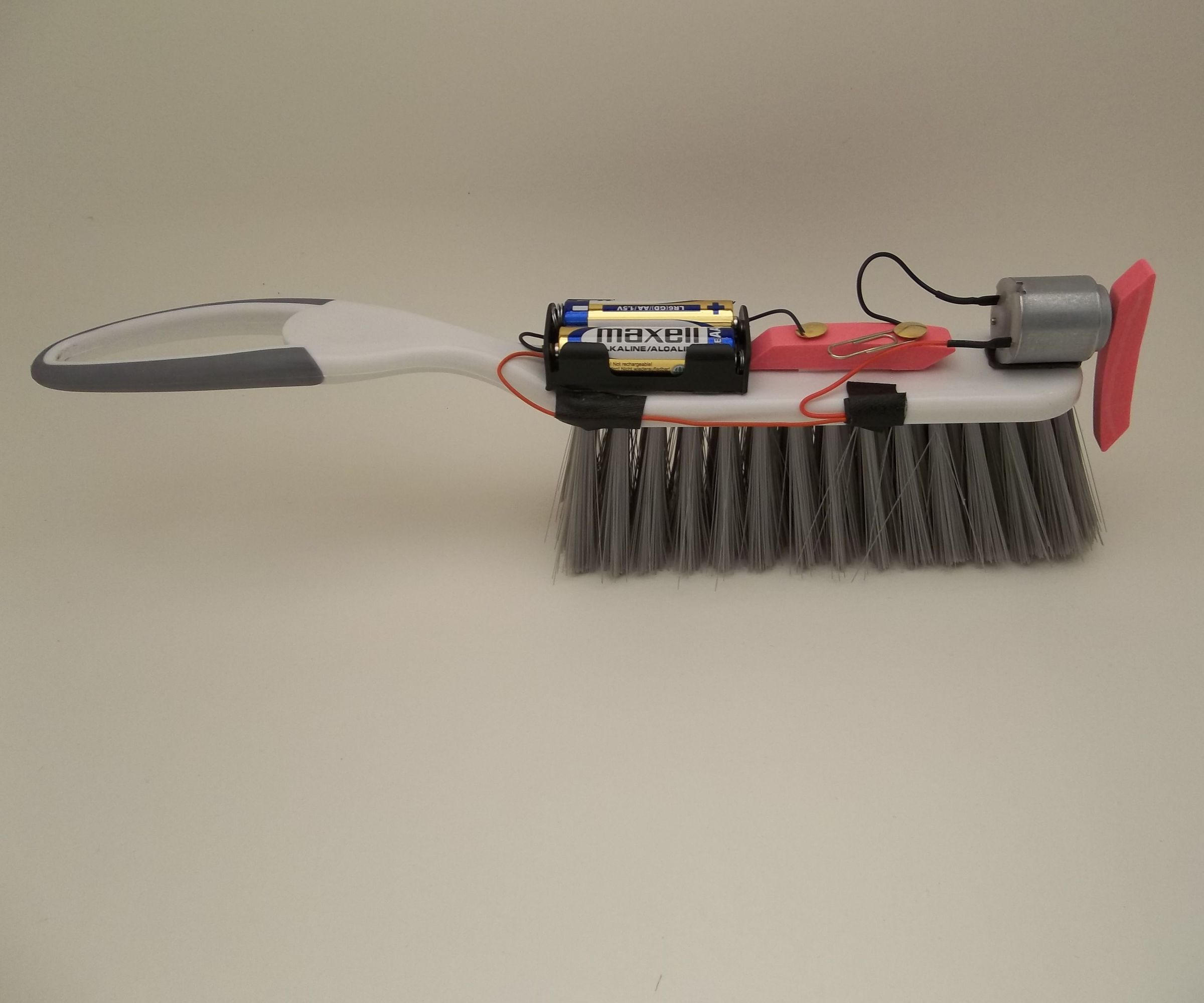

Step 1: What the Heck Is an Artbot?!
Artbots (aka scribblebots, vibrobots, bristlebots, brushbots...) are a classic Maker beginner project where a vibrating motor causes a body (usually a cup) to shake and scooch along the ground on legs made of markers, thus leaving a colorful trail as it moves. Artbots use a simple circuit with a switch, a motor, and a battery and are very adaptable to almost any lesson plan or learning goal. You can focus on electricity, or balance for the younger ones, or even biology if you want to make artbots in the form of anatomically correct insects, bacteria, or other animals. Heck, you could probably bring these into a college class and start a pedantic debate about what counts as a "robot" or "art". The focus is up to you, and can potentially cover a wide range of STEAM topics. Technically, artbots are simple and forgiving, they lend themselves to open design, and aren't as paint-by-numbers as some other robotics platforms. Best of all, they are super affordable and don't require a lot of tools or prep work. For me, when running a series of workshops, artbots typically subsidize the more expensive robotics workshops.
