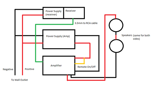

The most difficult part of this build will be finding a cheap amplifier. I managed to find a Coustic 102 amp along with two 6" house subs from a swap meet for $1 since the amp was originally not working. Your best bet will likely be to hunt through swap meets, garage sales, and craigslist. The Coustic 102 I found has a max output of 40 watts per channel at 2 ohms per channel.
Once you locate an amplifier you'll need to find a power supply. The owner's manual should be referenced for voltage and amperage specifications (google is your best friend here). If an owner's manual can't be found check the amp's fuse for the amperage, and if you have an amp made for car audio the input should 14.4 volts (12 volts will work). The positive output from the adapter will be connected to both the positive input and the remote on/off from the amp. Power for the bluetooth receiver is best supplied by a standard usb wall adapter. Both adapters should then be wired in parallel with the main power cord (all positives should be wired together and all negatives should be wired together).
After the power supply has been sorted the bluetooth receiver can be hooked up to the power supply and connected to the amp using a 3.5mm to RCA cable. Your speaker arrangement will depend on the amplifier you select as well as your speakers. Again an owner's manual should give you all the info you need as far as what your amp can handle.
In order to figure out your speaker arrangement you'll first need to understand how to add the resistance of the speakers. Resistors in series add together normally. However, resisters in parallel are added by taking the reciprocal of each resistor, adding the reciprocals, and taking the reciprocal of the sum, like so: 1/R1 + 1/R2 = 1/Rt. For example, two 4 ohm speakers wired in series will result in 8 ohms total, where as the same two speakers wired in parallel will result in 2 ohms total. While a lower resistance will generally allow more power to be supplied to the speakers, not all amplifiers are stable at lower resistance values, again the owner's manual should be referenced.
Once all of the above has been accomplished a bench test should be performed. Check for any crackling, popping, or other distortions and check your connections as needed. Make sure to be thorough as the system will be more difficult to troubleshoot once it's placed in the enclosure.
