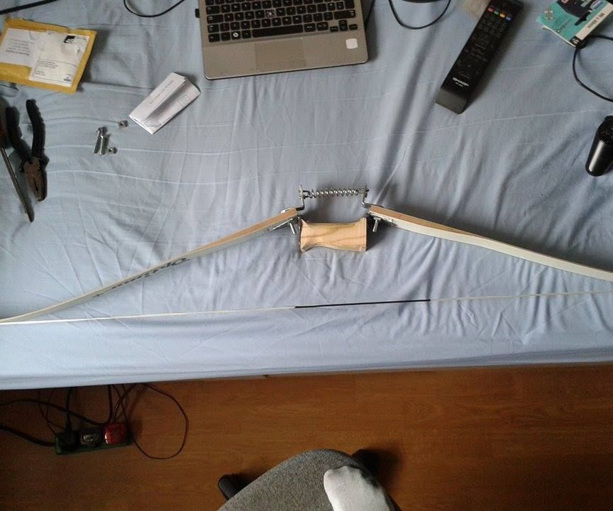

I started of with a block of what i believe is pine, the uni doesnt have a great selection of woods to choose from. I made this once and the wooden part broke so i remade it with some minor changes but ill get to those later.

I began with a block of wood and drew on the design for the side of the bow with a board pen i found. There are quite significant problems with this method; One is that the pen was large and imprecise making cutting the fine edges difficult, the second was that because i didnt put much thought into making it so much as diving straight in without a plan the bow isnt even.
Next i turned the bow on its side and cut that part in the same manor. Then i just sanded the edges on a bobbing sander.

This is one of the sections where i forgot to take pictures. I guess having metal limbs that are fairly removable makes it a takedown bow, but i didnt know what that was till yesterday so its all coincidence. In any case the metal was something i found lying around the workshop, a bit of cutting of the points to make it better and drilling holes through the ends. The bend i made by simply putting one end in a vice and manually bending it to a certain point. i made the limbs the same just by looking at the lying against each other. I attached the limbs with the wooden riser with two bolts at either end.
For the bow string hooks i made wooden triangles as anchor points and screwed the hook into them through the metal limbs. I attached the bow string making sure that it was well strung with lots of tension.

The problems from the first version were that the metal was not sprung so the wood took all the strain of bending and snapped at the weakest point. Once pulled on it would bend one way but not bend back into shape so id pull on the bow string till it could fire but once there it wouldnt fire and all tension was lost.
I fixed this by attaching medical tubing on to the front of the metal limbs. These act to pull the metal back into shape once you pull on the bow string and allow for it to fire. Unfortunately the bow isnt very stylish, awkwardly heavy because of the limbs but is powerful enough to make a hole in my door with a flat arrow head, they made me remove the metal arrow tip for "safety reasons"
