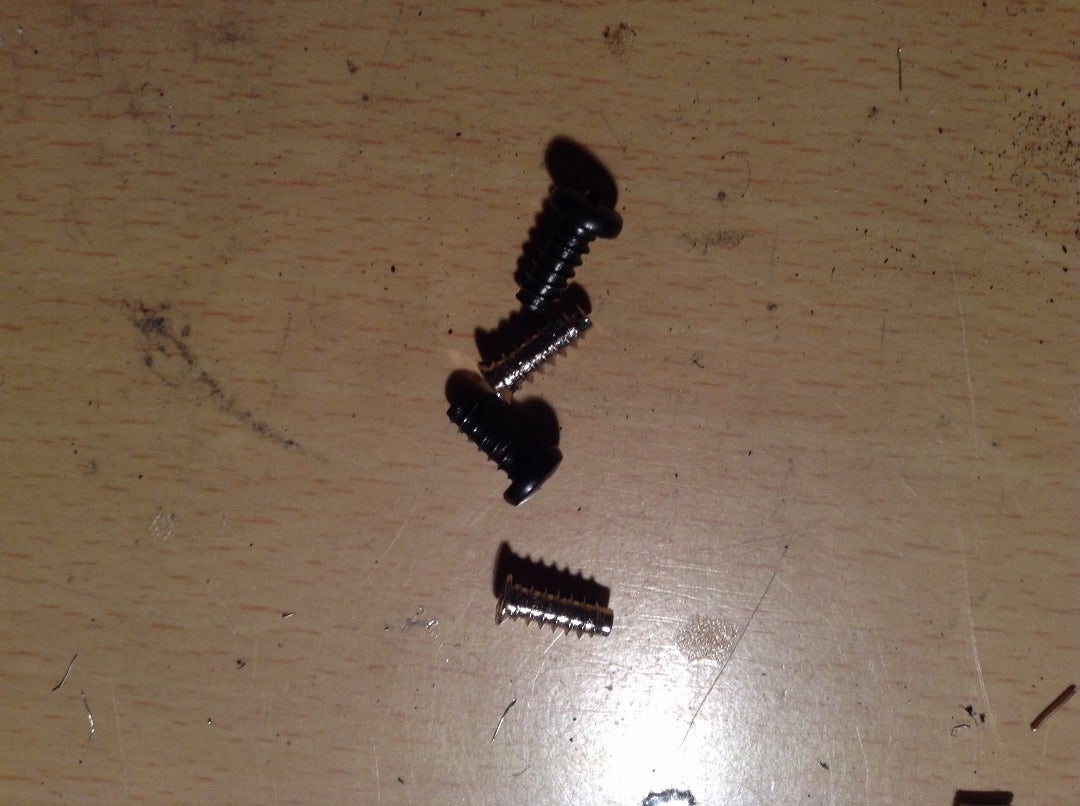

  • 6 Screws (Must thread into fan holes)

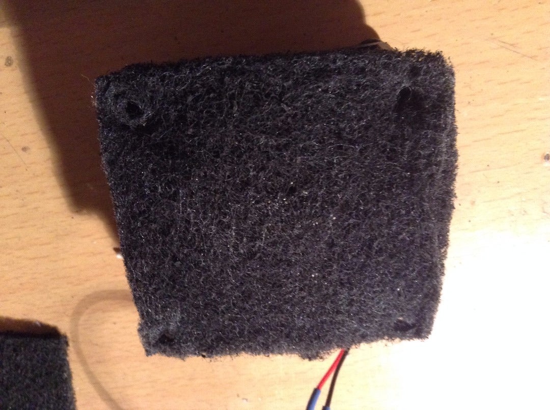

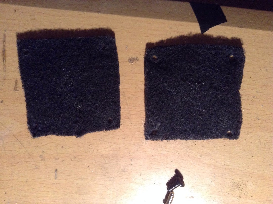

Form your carbon filter by setting it over the computer fan and cutting it so it barely overlaps the sides of the fan. Next, put holes in each corner of the carbon filter square. Finally, make another one.
Step 3: Assembling the Fan

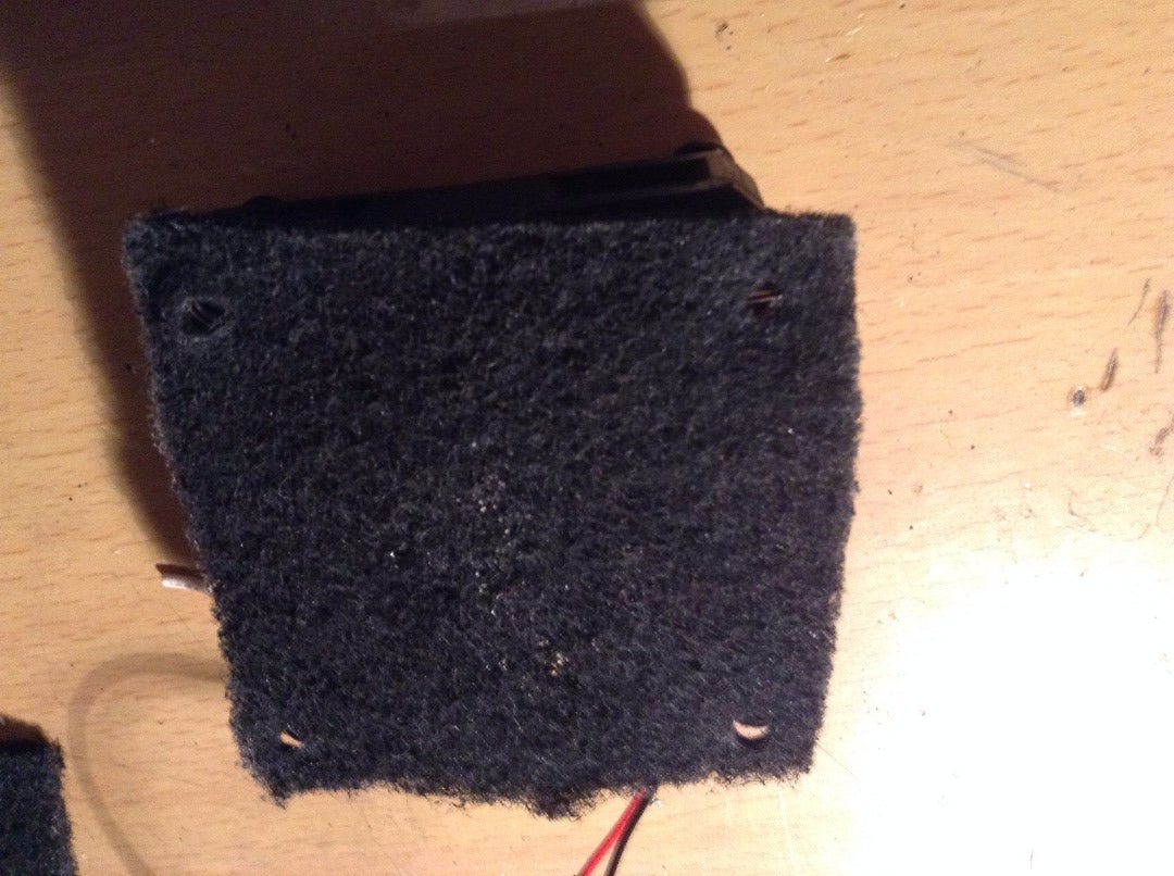

Assemble your fan by adding the fan grille first, then putting the 2 carbon filters on top of it. Make sure to put the grille and filters on the intake side of the fan. Then, add 4 screws going from the top of the carbon filter, through the grille, and threaded into the fan. Finally, Put 2 screws into the back as stands to keep the fan from falling over.

You can test your soldering fan by connecting it to power, and then soldering 1-3 inches away from it. All the soldering smoke will move towards the filter and get absorbed. The air coming out the other side will be clean.
