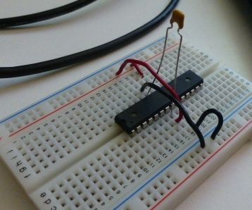

You can build an inexpensive robot platform following the instructions on this great web site which shows how to build an Arduino clone using a Radio Shack kludge board. This version includes all the hardware interface to have a Babuino. The picture shows the robot platform you can build following the directions provided. You can also keep an eye out for my Simple Robotics Breadboard Instructable (coming real soon now - really!).
