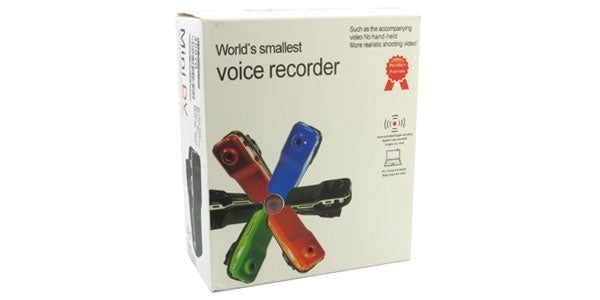

Step 1: Materials
Parts list:
* Micro video camera ($13)
* Head-mounted lamp ($3)
* Screwdriver
* Rubber-band
These Micro DV cameras range in price from maybe $90 to $13 shipped. It may depend on whether they're being sold in a spy store or as a toy for children :-)
The head-mounted lamps are all over the place now. Mine was a cheap one from China which was already broken, so I didn't mind dumping the flashlight to free up the headband).
