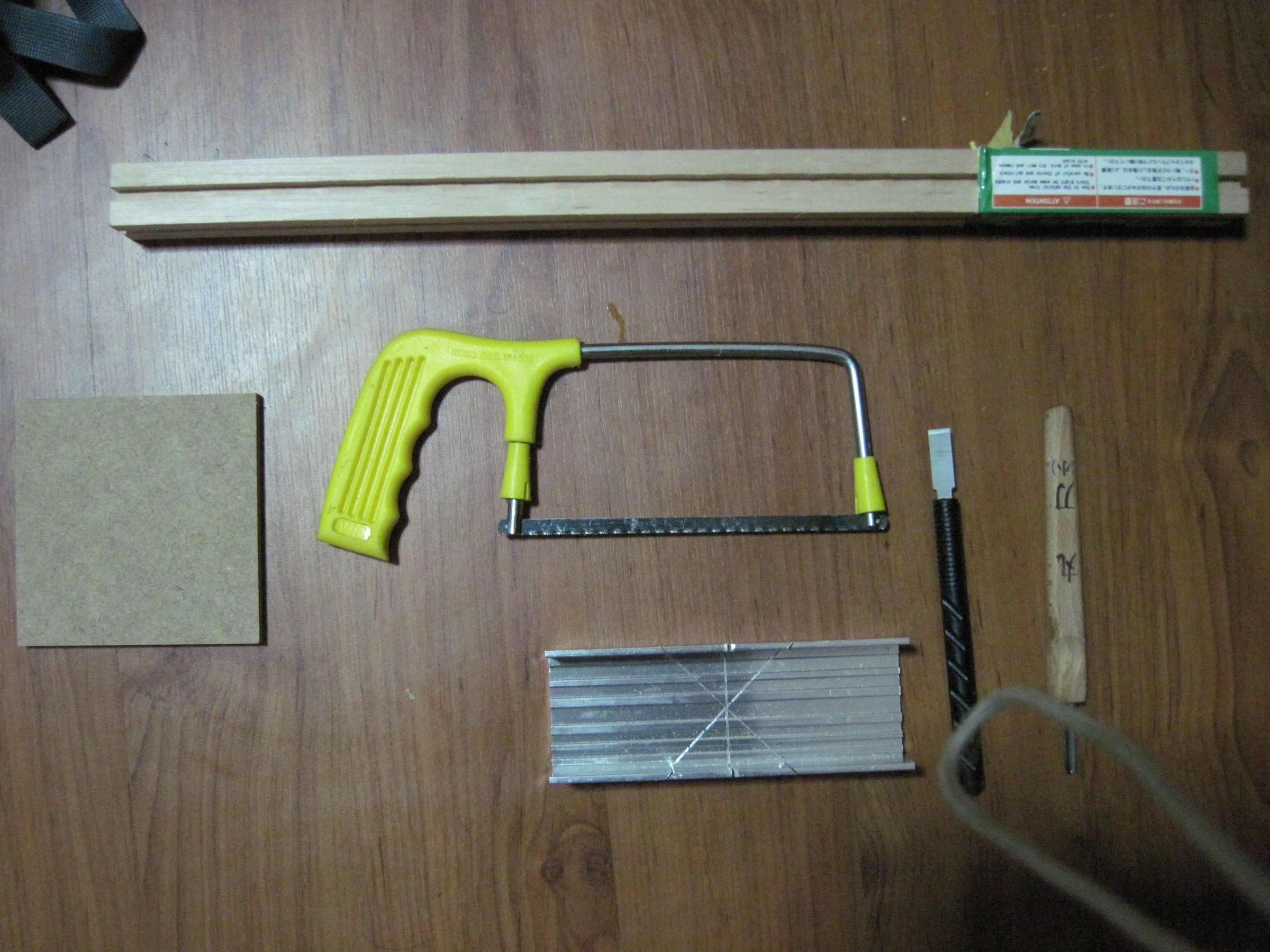

As you can see, the tools needed are fairly simple. I'm using 10MM by 10MM by 6mm, pre-cut MDF as a backboard - its very rigid, can be drilled with hand tools and cost me about 2 singapore dollars for 6. You can probably reuse it for future projects too if you don't permanently fix the standoffs. You will also need a pin vise with a 3mm bit (i'm using a tool i got at a local store that's basically a fixed bit pin vice) to drill the holes in the board
You will also need an appropriate number of M3 brass hexagonal standoffs and screws - the same number as the circuit board you're building. You should also start on this *before* you solder everything on the board, but i've done it after so its possible.
My tools cost about 4 dollars, and i spent around 2 on materials - which isn't bad since these are reusable
