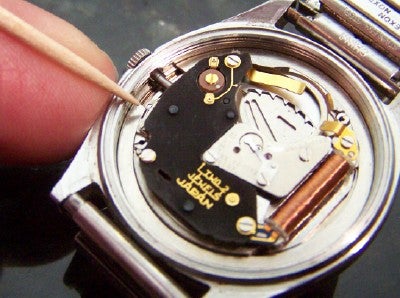

This is my Seiko quartz analog watch. It is almost 19 years old.. In recent months have I noticed it slowly drifts a couple of minutes from the correct time. I checked prices for cleaning and lubrication through an on-line watchmaker. By the time all fees are paid, repair costs would be almost equal to the price of a new watch. Repairs could cost more yet if any parts need replacement. Similar watches to mine are available on eBay and I might be able to find one for less with a movement I could substitute in my watch case, if all dimensions are the same. But, that would be a big risk. Because this watch was given to me by my wife on our 25th wedding anniversary I really want to keep it rather than replace it.
Step 1: A Local Watchmaker
We live a couple of miles from one of only a few a watchmakers in our very metropolitan area. Because droplets of moisture have sometimes gotten into the watch and condensed on the inside of the crystal, I wanted to talk with him about cleaning and lubricating the watch. The watch also stopped recently, but I got it going again by gently poking with a toothpick at the wheel that drives the second hand. I thought there may be a tiny piece of debris inside the watch, and cleaning would be a very good idea. The watchmaker has a very thick foreign accent and shook his head, "No!" when I asked about cleaning. He said, "New battery! One year!" When the watch was new, the first battery lasted 7 years. I have 3 1/2 years on the present battery. This watch is still supposed to keep accurate time when the battery is getting low, but the second hand begins to jump in 2 second increments every 2 seconds as a sign the battery needs to be changed. I have not seen that, yet, so I assume the battery still has some life in it..Still, some sites urge replacing the battery every two years, even if no inaccuracy problems are evident. I do not know if it makes a difference, but the watch came with a silver-oxide battery. The present battery is an alkaline battery.

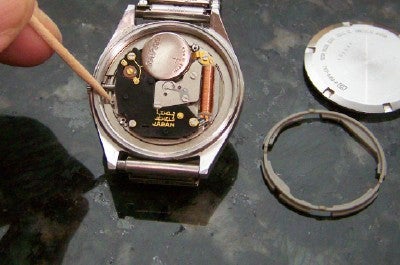

I decided to attempt blowing a little compressed air through the watch movement in order to remove any loose dirt that might be slowing my watch.* It is generally a bad idea to assault fine mechanical devices with air under pressure.** I began by removing the back. See this Instructable on making a wrench for backs that unscrew.

Step 3: Take the Movement Out of the Case
Update: If possible, you may want to avoid removing the movement from the case. A few days after doing this Instructable, I decided to tinker with the watch just one more time. When I finished the stem would not go back into place fully. I probably could have lifted the movement enough to use the compressed air as described in step 4 without removing the stem. Now that I cannot get the stem back into place, I will either need to pay a watchmaker to repair the watch, or put the watch aside in a drawer.

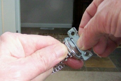

Lift the plastic retainer out of the watch case and depress the lock that holds the stem in the movement. The stem must be pressed inward as far as possible. The locking piece disappears when the stem is pulled outward without releasing the lock. On Seiko watches the stem lock is very often a springy piece of metal near the stem and it has a small hole in it. Look in the photo near the end of the toothpick. See also the second photo. Push downward on the piece with the hole while pulling the stem out of the watch case. A ballpoint pen works well enough for this, or you may use a jeweler's screwdriver. A toothpick splinters and leaves debris in the watch case.

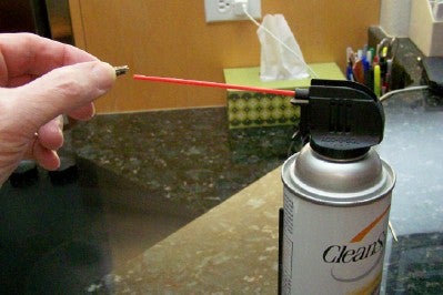

I used short bursts of canned air I bought at an office supply store. This is the kind of canned air that is free of dust and humidity. It is often used to blow dust from inside a computer. I tried to avoid spraying air at the delicate watch hands to avoid pushing them hard if blocked and to avoid bending them, but I focused on aiming air into the open sides of the watch's movement. If this were a mechanical watch with a balance wheel to regulate the movement, I would be very careful with pressurized air near the dainty spring on the balance wheel.

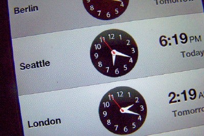

A watch needs to run 24 hours to determine what effect adjustments have made in the performance and accuracy of the watch. I chose to use the World Clock application on my phone to check my watch's accuracy. I could also have used the clock face that opens in the lower right corner on my Windows PC screen. Choose one clock and do all checking with it. Clocks that are supposedly steered by an atomic clock somewhere can vary from one another by a second or two, and mixing clocks could make you think your watch is less accurate than it actually is. Notice the red second hands in the photo all indicating 55 seconds.* I synchronized my watch and its second hand with the display in this World Clock app. So far it appears that my watch is running accurately again, and it cost me almost nothing. Try this on your own watch with caution. It is, as I mentioned, a really bad idea, but one that did work very well for me.
*The black clock faces indicate it was dark in those parts of the world when this photo was taken. The clock faces are white during hours of daylight in the respective parts of the world. Still, the second hands on these clocks are easy to see.

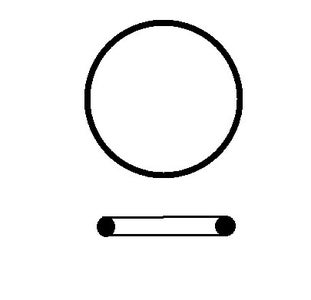

The graphic is a depiction of an "O"-ring, including a cross sectional view. The diameter of the material and the internal diameter are the key measurements for a watch back.
