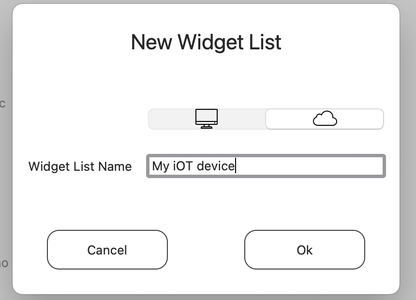

  1. In the left menu click Widget Lists
  2. Click New
  3. Enter the name of the new Widget List: My iOT device
  4. The Widget List can be stored locally or on the iCloud. When stored on the iCloud it is shared and accessible from any macOS or iOS device signed in with the same Apple ID. The Widget List can be move to or from the iCloud later
  5. Click Ok

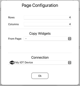

Open the Widget List (click Widgets) and then open the Grid Configuration (top right side of the screen) and select the just selected connection in order to use it in this grid.
Please note:
  • Can be defined a different number of Widgets for each available Widget page
  • Each Widget page can connect to a different board and each connection can be activated independently

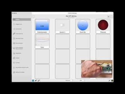

The attached figure shows the final Widget List configuration.

Step 10: Test Everything
The iOT device has now all the planned feature. To test it:
  1. Run the last generated code from Thonny
  2. Get back to Arduino Manager and connect to Pico W
  3. Display Widget shows up the voltage at potentiometer's wiper
  4. Touching the Switch Widget, the Yellow LED on the device turns on and off
  5. Switch off the Yellow LED, then Pushing the Push Button Widget on Arduino Manager, the Yellow LED turns on and stay on until the Push Button is released
  6. Pushing the button on the device, the LED Widget turns on

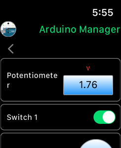

With a minimum practice in using Arduino Manager and the Code Generators, making this device is matter of minutes and practically no code writing is required.
Arduino Manager also provides an WatchOS version, hence the iOT device can be controlled directly from the Apple Watch.
