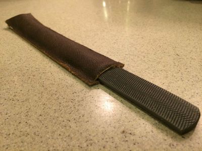

This sheath was made to give my new file some protection as it tumbles around in the bottom of my tool bag.

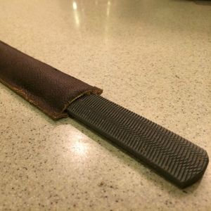

This project took me about 15 minutes in total from start to finish and was very rewarding to have created a functional leather piece without any fancy or expensive leather work tools. One thing I have not done yet but will do in future is probably rub something on the leather to protect it and also brand or stamp my maker mark on it.
This type of sheath making could be used for an assortment of other items such as a nifty looking glasses case. I have also used this technique to create a sheath for a pair of calipers that I had received with no case.
