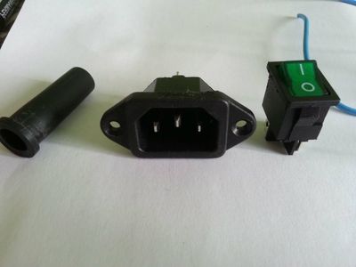

Step 1: Material & Tools
- Switch with pilot light
- cable grommet
- Ac panel euro plug male
- Piece of wire
Tools

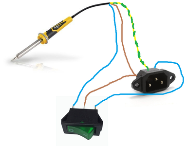

Step 2: Prepare Snatd
Layout the parts and mark positions with marker. Then cut holes with soldering iron with cutting tip and smoothing hole with knife
Step 3: Wiring
(She switch can have litle different pins)
After soldering wires I glued them with hot glue gun to isolate for safety.
