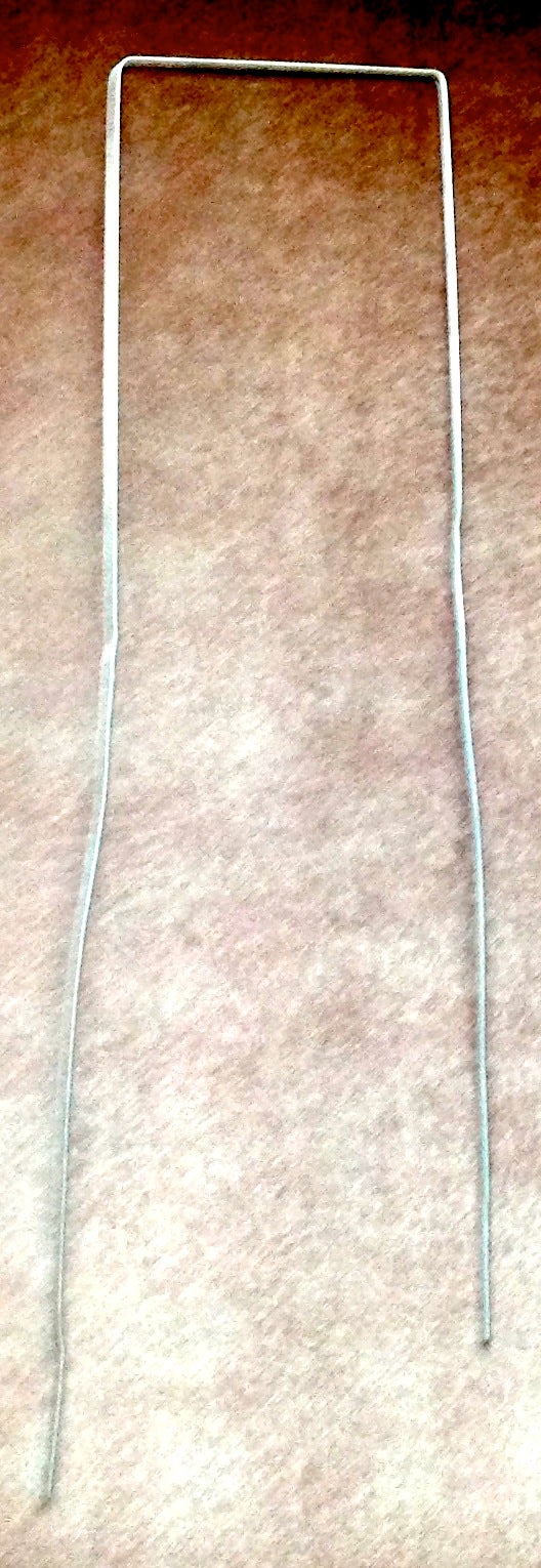

Step 1:
Cut the coathanger fairly close to the hook and straighten it as much as you can. Bend it as in the photo, centering the bend in the coathanger as much as possible. Don't worry if it isn't precise, we can cut off any excess so as to even things up later. Make sure the bends are square and that the remaining wire is more or less parallel.
