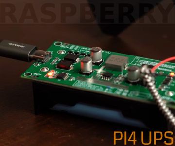

Step 1: Fixing the UPS Filtering, Replacing Ina226 Shunt
The electrolytic capacitors on the output need to be replaced with MLC ones otherwise the output is too noisy. For more details about the noise problem/fix you can check this Great Scott video.
To be able to measure current up to 3A the Ina226 module needs a shunt resistor R008 (0.008Ohm), the board comes with a R100 shunt which is not enough for the RASPi current draw. The next step is to swap the original shunt with the R008 SMD resistor.

Vbus is soldered to the battery + pin on the UPS board, the orange wire in capacitor fix image.

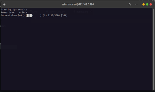

After configuring and running the command above you should get the output from the last image. This indicates that the software is functioning correctly.
You can now proceed to the "To install as a service" section to install the script as a service.
Once the service starts successfully, the script will run in the background, monitoring for power outages. You can simulate a power outage by unplugging the USB-C cable.
Upon reconnecting the cable, the UPS module will resume charging the batteries to full capacity, and these events will be logged in the "events.log" file.
If power is not restored, the UPS will automatically shut down the Raspberry Pi when the battery voltage drops below 3.2V.

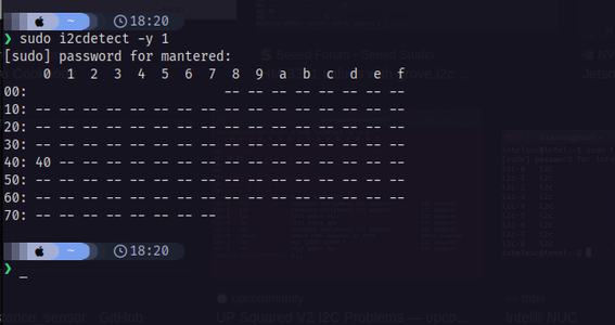

If the INA226 module is not detected you'll have to check the module address:
You can check the address with the following commands, the default address used is 0x40.
sudo apt-get install i2c-tools
sudo i2cdetect -y 1
If the address is different than 0x40 you'll have to add "address=0xNUMBER" in ups_daemon.py (pi4UPS.py line 36) file at line 31:
ina = INA226(busnum=1, address=0xNUMBER, max_expected_amps=max_amps, shunt_ohms=shunt, log_level=logging.ERROR)
