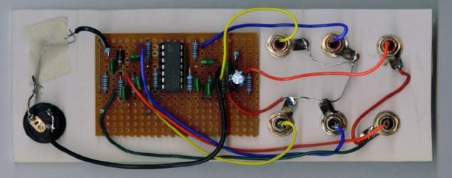

So much for the theory, how about construction? To keep costs down Ive used a piece of 0.1 matrix copper clad strip-board measuring 11 strips by 22 holes across. Looking at the diagram this shows the layout. Note that 'X' indicates a break in the track and these should be made with a suitable cutter at the places indicated. This is the first task of construction. Next drill the hole in the panel at F13 to take a 3mm screw.
It's almost a must to mount the diodes first. Otherwise youll end up struggling trying to insert them between the caps.(take it from me! ) Also it makes life easier to temporarily hold components into position with a piece of masking tape to stop slippage when soldering. Note that the diodes are soldered the right way round. Polarity is indicated by the light band at one end of the component.
Next install the electrolytic capacitors C1-4. Again these are polarised as indicated both on the component body and layout diagram. At this stage the board is finished and can be put on one side while attention is turned to the plastic panel.
