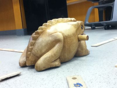

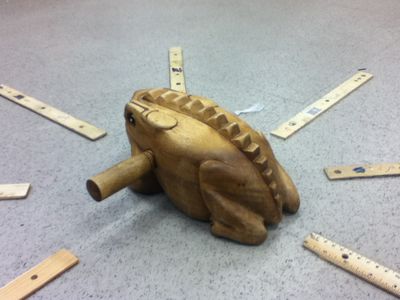

Take 6-70 photos of your object.
I had best results when I took ~60 photos.
Every photo should be 12 degrees around the object.
Then I went up from another angle and took another 30 photos around the object.
Here are some of the sample angles I took.
Also make sure that the object is always int the center of the image so that nothing is cut out
