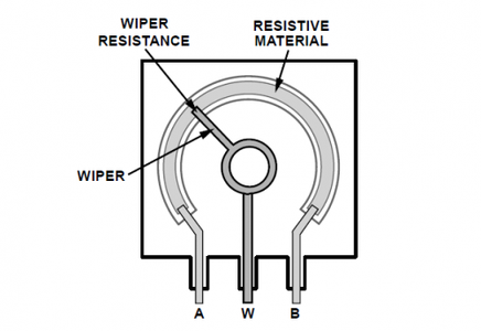

As you can see in the picture, all a potentiometer does is change the amount of resistance between middle pin B and the outer pins A and C. as the resistance between pin A and B increases, the resistance between B and C decreases. Therefore, to wire a potentiometer to and arduino you connect one of the outer pins to the 5v pin, the other to ground (switching these reverses the the direction you have to rotate) and the middle to one of the arduino's analog input pins-I used A7(Analog pin 7). As a result the arduino will receive a voltage to the input pin dependent on the position of the knob. When reading analog inputs in arduino, use the numbers in the green boxes for the method's parameters.
If you already know how potentiometers work or don't care skip the next 2 paragraphs. I won't be offended:)
If you are wondering why we don't just wire 2 of the pins and use the knob to vary the resistance, it is because the arduino works like a voltmeter and measures potential. So imagine the 5v pin and pin A7 as two probes of a volt meter- no matter what the resistance is between these pins, even if it's an open circuit the pin A7 will read 5v(since the pin is at 0v). But what happens when you add a resistor in series after pin A7? We have a voltage drop, and if you can control the value of this resistance like say a potentiometer, you can control the potential across pin A7 and the 5v pin
So when the wiper(look at the picture) is rotated all the way right, the arduuno is just measuring potential difference across a single resistor(you can only draw one path through the circular path and the wiper), reading 5v. As you rotate the wiper left the arduuno is still measuring the potential across one resistor except now there is another(the rest of the circular resistive material) the value of which depends on the position of the knob.
I hope this makes sense. If you want to see for yourself take a voltmeter, a battery, and 2 resistors. Start of with a single resistor connecting the 2 terminals of the battery. When you put the voltmeter across the resistor you will get the voltage of the battery. Now keep the voltmeter across this resistor and add a another resister in series before or after the resistor that you have the voltmeter across. You should see the voltage reading drop.

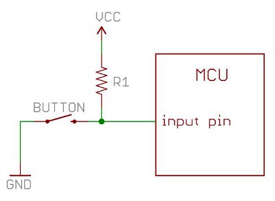

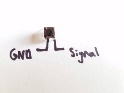

To wire the switch, one pin goes to ground, and the other goes to a digital input pin- I used digital pin 2. When assigning digital pins use the the numbers in the purple boxes. To protect the input pin you can add a resistor between the switch and pin. Also, don't forget to either set the pullup resistor internally or wire one manually. I know it's intuitive to simply add a switch between an input pin and ground, but apparently this will be a "floating pin," and due to noise it can turn on and off automatically. As you can see in the picture, in that circuit, the pin is either grounded or in a high state with 5 volts across it and never "floating." You can google this if you seek a better explanation.

Switch 1st pin:Gnd
Switch 2nd pin: choose any digital pin(purple box) no need for PWM

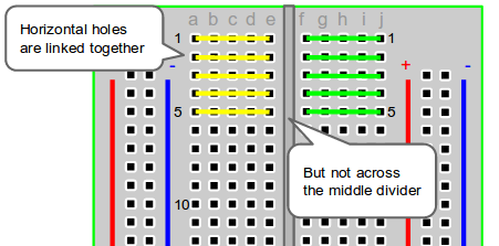

The picture above show which of the pins in a common breadboard are parallel, I highly recommend you use breadboard before soldering or connecting everything together permanently.

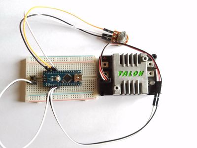

Here is the picture I drew for myself before wiring (pot stands for potentiometer). I hope it can help you.
Here also some pictures showing the pins of each component, how they are connected, and everything plugged in together.

Step 6: Plug the Controller In
For your sake, please don't start off by controlling a powerful motor. Start with something small such as a computer fan(if your controller is meant for dc motors) or even a voltmeter to test with. Once you are confident in the hardware and code, control/test your motors to your hearts desire.
