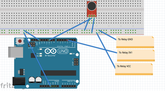

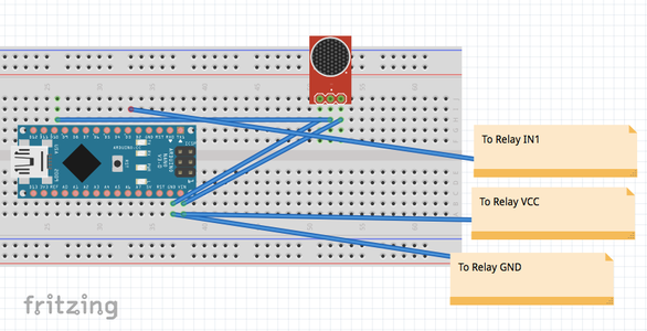

Step 3: The Arduino Circuit
The Arduino circuit is a very simple one:
Microphone GND > Arduino GND
Microphone 5v/vcc > Arduino 5v/vin
Microphone OUT > Arduino Digital Pin 10
Relay Module VCC > Arduino 5v/vin
Relay Module GND > Arduino GND
Relay Module In1/in > Arduino Digital Pin 3
Or Refer to Fritzing diagram
