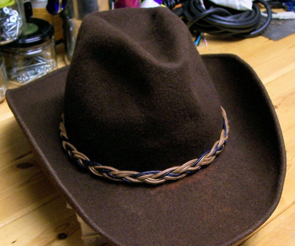

Introduction: Cheap and Easy Hat Steamer.
Following on from my hat stretcher 'ible I had planned to do one about stretching & reshaping but decided instead to start a project that I've been thinking about doing for a while now.
Wherever you look online for information about reshaping hats you will find people suggesting using a kitchen kettle to steam them, I've done it myself & it does work but there are a couple of limitations to the method.
Firstly if you want to get your steam onto a particular part of the hat without getting too much onto other areas it can be quite difficult to do so over a kettle, the steam comes out in a huge plume & will not only get to pretty much all of your hat at once it also has an unfortunate tendency to do nasty things to unprotected areas of skin that may inadvertently get in the way.
Secondly kettles have this annoying habit of switching themselves off when they come to a boil & your supply of steam gets cut off, it is of course possible to stop this, you could jam something in the switch for example or if you are a bit more electrically competent you could bypass the cut off switch, both these methods would work I know because I have also done them but neither will really do your kettle much good in the long term & neither will resolve the first problem of not being able to control the steam.
What you really need is an easy way of getting your steam from the vessel to the hat without scalding yourself or worse still setting fire to your kettle/kitchen/house.
Milliners & hat shops use purpose made steamers that give a directed gentle jet of steam leaving both hands free to manipulate the hat but even a fairly basic model like the Jiffy J1 will set you back up to £200.00 which is ok if you are going to use it all the time but for the kind of occasional use someone at home would need it is a big lump of cash to pay out.
With this in mind & decided to make one for myself and as usual I wanted to do it for as little cash outlay as I could & preferably for free.
