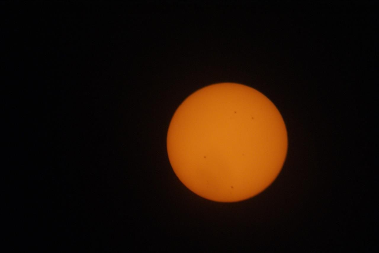

Reply 8 years ago on Introduction
I got the attached photograph today at ISO 800, F11 and 1/8s with a 400mm and 2x on a APS-C sony A300, so 1200mm equivalent telephoto.

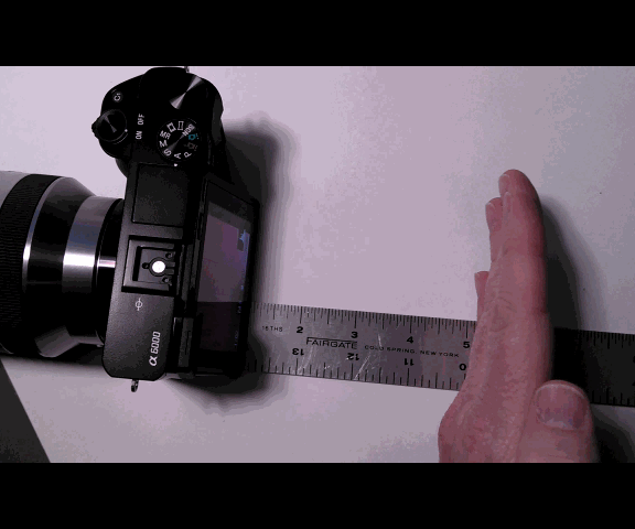

I really recommend using cameras that don't have a "through the lens" eyepiece, but instead use an OLED screen just for eye protection.
Here are some older shots I took with my A77 using an IR filter only. Again, because it's OLED eyepiece it was safe. EXIF info is there.
https://www.flickr.com/photos/trophygeek/734389626...
My newer Sony A6000 camera has a "Full Spectrum" conversion which basically replaces the internal UV/IR cut filter with a clear filter. This means it picks up light well into the infrared part of the spectrum. I haven't tried it with the solar filter, but I'm curious to see how it behaves.
OK. I found my original set of photos I took for this article.
This shot's information is:
Sony A77
ISO: 50
6.3F @ 1/13th
Focal Length: 250mm (using a Sigma 18-250mm lens)
