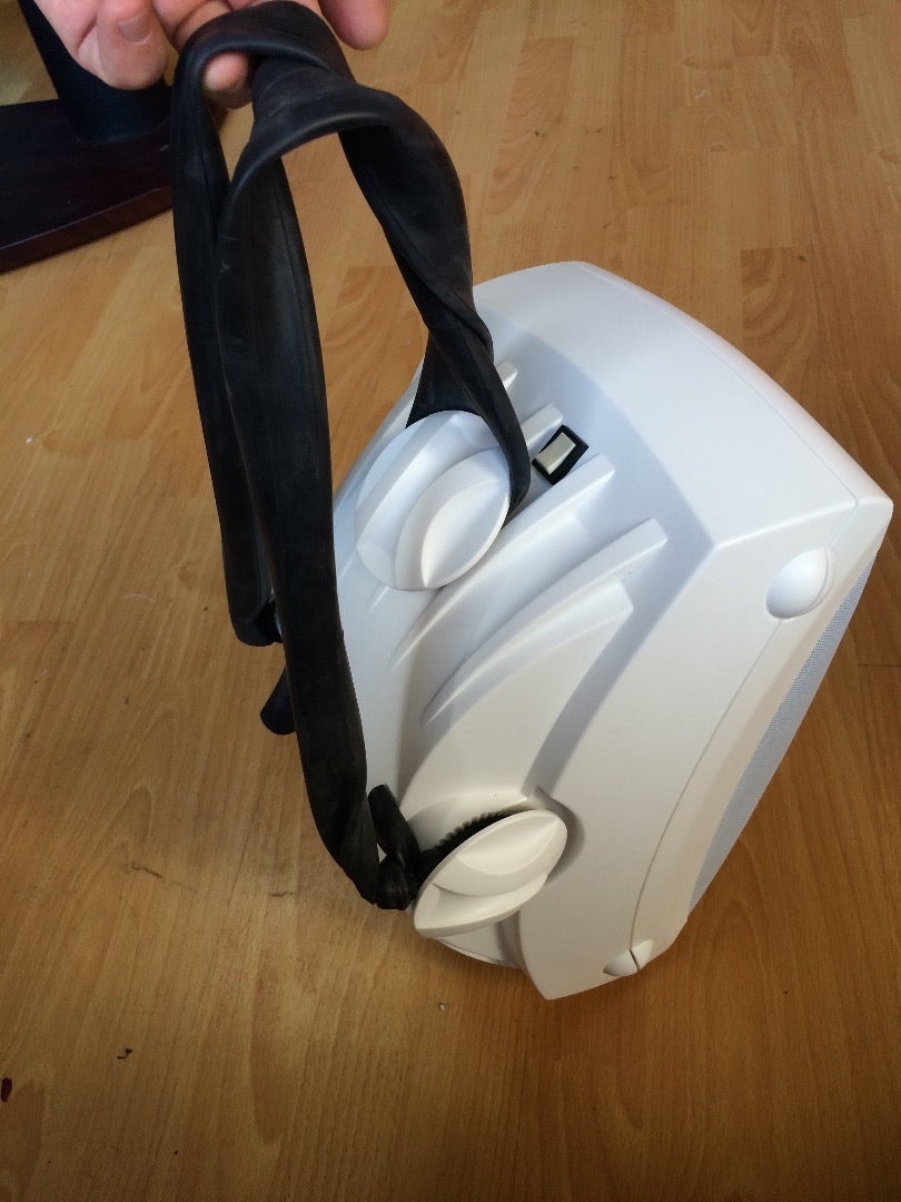

I even made a back strap out of a used rubber bike tube, so it can be worn like a backpack.

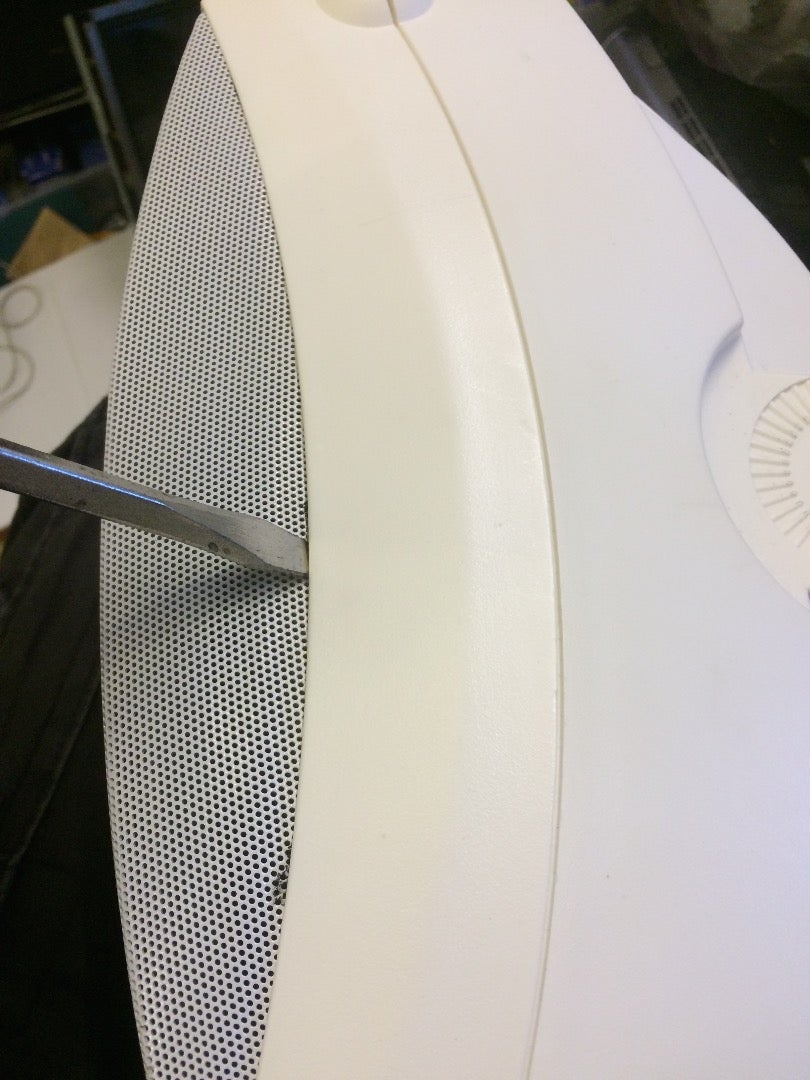

The metal cover protecting the speaker drivers is held on by some adhesive along the edges. Gently push it inwards and using a flat head screwdriver, carefully work your way around the edges and pry it off a little at a time.
Once you get the front cover off, there are 6 phillips screw holding the back cover on.
Undo these six screws. I used the metal cover as a parts holder as I was working.
The back cover also has some adhesive, so pry it apart with a screwdriver similar to the front metal cover.
When it starts to separate, be careful as the wires inside connect the two halves and we don't want to pull them out until we are ready.
