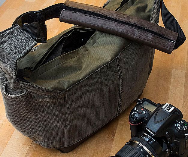

Every photographer knows improving your equipment is part of the fun. But every time you add something, your good old camera bag looses some of its handiness or simply becomes too small. Until now I have had to buy a new photo bag to adapt to the ever changing shape of my camera, everytime I upgrade my stuff...
Take for example my latest favorite bag: A Lowepro Passport Sling – urban, discrete, classy and stealth, but that little green inlet is way too small to contain my new 24-70 mm 2.8. Mind you, the bag would be big enough if only the inlet would accommodate the lens. Bottom line, instead of buying yet another bag, I found out how to tailor make just the right inlet!
Everyone is different, so I made this instructable as generic as I could, so everybody should be able to make their own custom design.
(Note: This instructable will explain the principles of how to construct the inlet, but not be an in depth instruction on, how to sew as such. And I also have to warn the handwork teacher amongst you – I am an self-taught amateur on a sewing machine... ):-)
