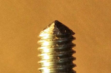

Step 2: File the Bolt
To give you spike a sharp point, you have to shape one end of the bolt with a file or grinding wheel. How sharp, depends on how you want to use it. If the speaker will be use on a solid floor, a point like in the photo will be sufficient. If, however, it has to penetrate a carpet, it will have to be filed to a much sharper point. Remember to shape the end where the bolt was separated from its head, and the thread thus already damaged. That way the "good" end of the bolt will stay undamaged.
