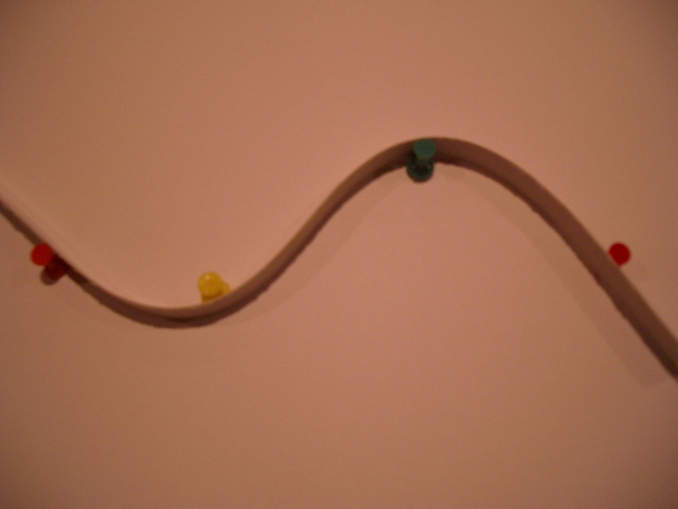

On the bottom edge of the 5' 2 x 6, cut a decorative profile. My table has a 4' wide arc that is 1-13/16" tall. A curve this shallow can be cut with a Skilsaw, if the blade depth is set to exactly 1-1/2". Other options are shown in the PDFs. Check out my Instructable on laying out curves.
