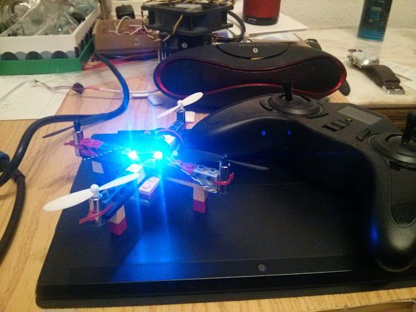

I used Lego Technic because it has holes in the bricks. You can mount the motor's with tie wraps through the holes and it's an ideal weight reduction. For the motor's and flight controller I used parts from the famous Hubsan X4.

This requires a little soldering but nothing really hard. If you look at the flight controller, the place where you need to solder the motor's is already labeled.
And as you've probably seen there are clockwise and counterclockwise motor's. It's important to place the same motor's opposite of each otter. So clockwise motor opposite of the other clockwise motor and same for counterclockwise.
The flight controller already has some soldering tin on it, but it's not much. So you can add some extra if you want.
Step 3: Building Your Lego Frame
I will let the pictures do the talking. You don't have to build exactly the same frame I build. With a little imagination you can build some awesome frames! Just don't make the frame to heavy or it will be very hard to fly (if it even has lift off). Please share you awesome frames for inspiration!
Step 4: Mounting the Motor's and Flight Controller
What I mentioned earlier is that Lego Technic is perfect for mounting the props. It has holes in the bricks and all you need to do is mount the motor's with tie wraps trough the holes. I also used double sided tape to keep the motor's in place. Fixate the flight controller on top, battery under the frame and your good to go!

Hello again!
We put together the drone and connected the battery, leds starting to flash and it all seems to work great. One problem though, we can't get the controller connected to the Hubsan Control. Any ideas how to do it?
Reply 5 years ago
Hello there, sorry for the late respone... But if the leds are flashing when you connect the battery, that means it's waiting for a connection with the transmitter. Just turn on your transmitter when the leds are flashing and they should pair. After that, you should be able to control your drone.
Reply 5 years ago
Hi again!
It turned out that you need to push one of the rear end buttons on the transmitter when you started the transmitter in order to connect the the transmitter with the receiver. Now it all works just fine!
Reply 5 years ago
Cant remember doing this in order to connect. But great to hear it works, have fun!
