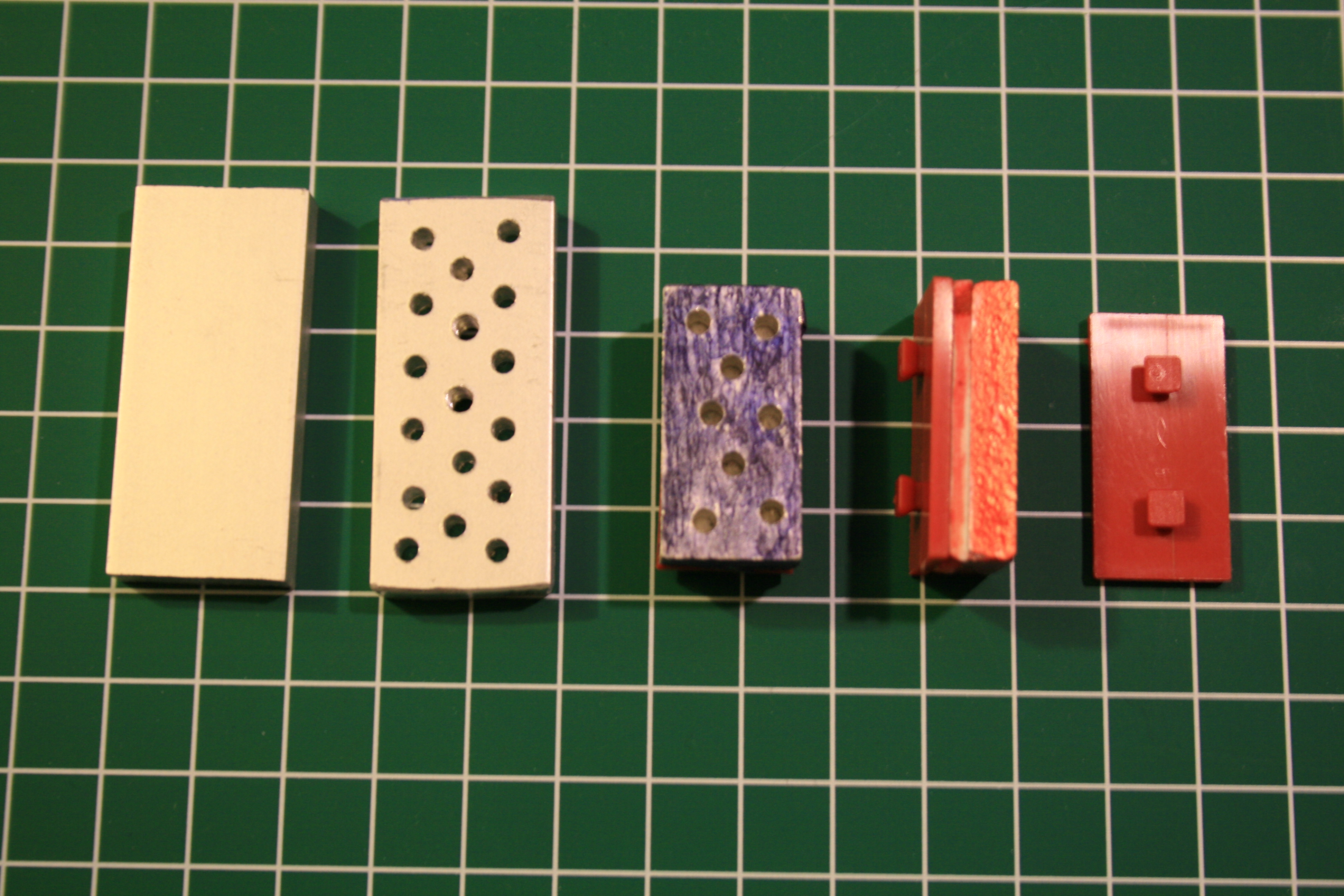

Step 1: Required Parts
By bending and soldering the connections have to be very careful otherwise break these out.
Reed switches are available for little money in the electronics trade. Depending on the purpose you have to select the allowed voltage and current. 2 A switching power should be enough in the toy environment.
For this example, I use a fischertechnik Building block 15x30x5 with groove and pin.
An additional components, we only need two 2.6 mm fischertechnik (or Marklin) plug and 20cm twin wire.
A magnet can stick with epoxy resin to any fischertechnik building block.
Step 2:
The reed switch fits nicely into the groove of the block.
So that the sensitive glass body is well protected.
Turn the reed switch so that takes place when the magnet is in the contacts before.
The groove we pour out with some epoxy. An alternative is also hot glue.
