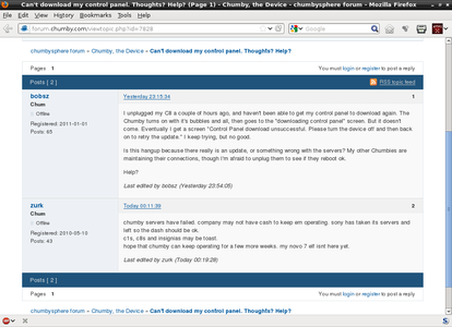

Note: all cloude services have been stopped for the Chumby. Check out http://hackaday.com/2013/07/25/making-a-dropbox-with-a-chumby-and-bittorrent/ for additional options for the Chumby. A bit outdted, also see http://forum.chumby.com/viewtopic.php?id=6411:

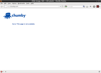

Chumby websiite seems to be back up again!

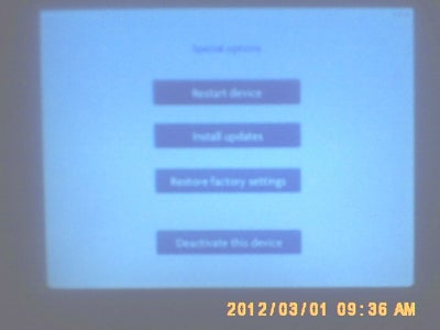

While pressing the touch screen, turn on the touchpad and keep pressing the screen til you get a message about the special options.
Let go of the screen.
You will be then asked to recalibrate the screen. Go ahead and do that.
Then you will get the special options screen
Choose install updates. (from disk drive)
Go ahead and let it install the update.
The system will install the first part of the update reboot and then install the second part plus the browser module. Do not interrupt the update at any time!!!

Note the Chumby server was flaky, so I put the original firmware back on the machine via usb. deauthorized the unit. Reinstalled the original firmware. Reauthorised  to insignia network. Then reloaded the updated Chumby 8 firmware. Back to normal so far.
Update: the Insignia network is gone. The only choice is the Chumby network.

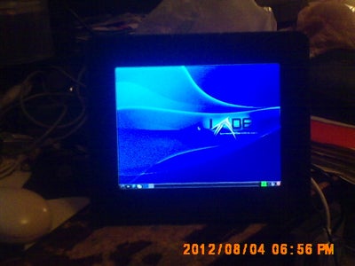

What's next?  May add a step for connecting to a media center such as xmbc. Android after reading what developers said, probably will not be on the Chumby. But, good news though as arch linux has been ported for the Chumby. If I can run the linux gui (aka X) on the chumby, not having android will not matter.  Have Debian Squeeze running on the Chumby now. Does not affect the base unit operation since it runs from a thumbstick.
Step 8: Debian on the Chumby.
Putting Debian on t he Chumby really deserves  a separate instructable. There are a lot of Gotchas, so I will wait till I can simplify all that before publishing the instructions.
