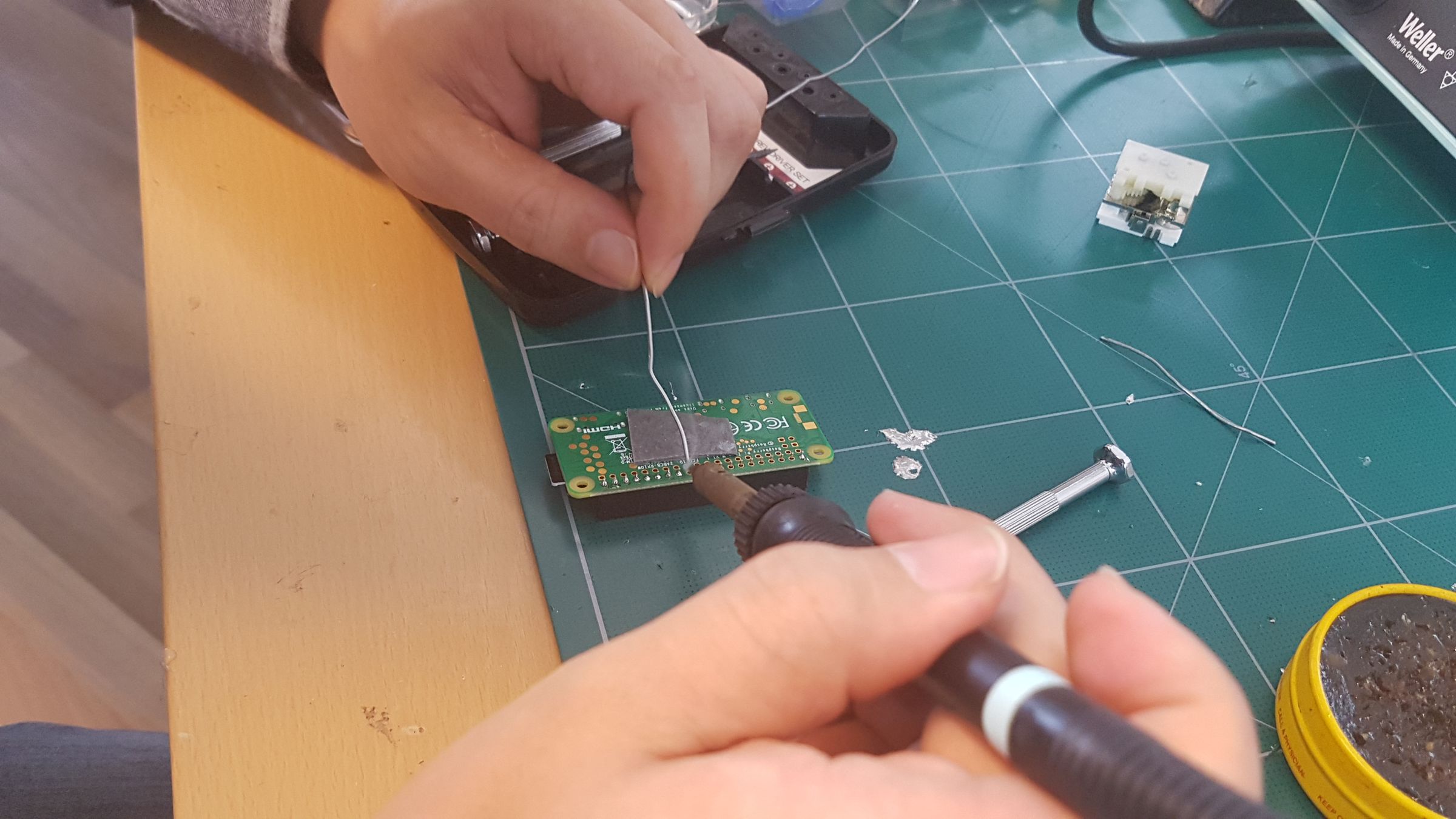

Step 3: SETUP YOUR SMART PLUGS
The Raspberry Pi Zero W does not have a header integrated but it’s very easy to add one (and you can buy it for less than $2 on Amazon). You can solder it very easily in a minute.
Thanks to those PINs, we can now connect the Raspberry Pi Zero W to our RF transceiver. The latter will communicate via radio frequency with your RF sockets to turn them on and off. It’s a very economical way to connect devices/appliances that can be triggered by just being connected to a power supply (like lights and TV).
You need to solder the RF transceiver and home-made antenna together. Make sure the soldering connects the antenna to the ANT port on the RF transceiver.
You can have more information on how to make an external antenna in this article.
Keep in mind that the required length of your antenna will depend on the frequency of your RF socket. Our OS supports 433, 477 and 315 MHZ.
Once soldering is done, plug three jumper wires to your RF transceiver (433/477/315 MHZ).
VDD = Electric current (5V)
GND = ground (select a ground PIN)
DATA = has to be connected to GPIO23
You can connect those three jumper wires as we did on PIN 2 (5V), PIN 6 (GND) and PIN 16 (GPIO 23).

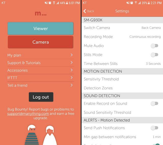

Step 5: TURN YOUR OLD SMARTPHONE INTO a SMARTCAM
You can turn an old smartphone into a smart cam by using ManyThing app, which is supported by IFTTT.
- Download the app on iOS or PlayStore depending on the smartphone you will use as a webcam.
- Sign up and choose “Camera” to put it in Webcam mode (Viewer is the mode to use on the device from which you want to monitor).
- Define the Settings according to your preferences
Try to find a point of view that would compliment the orientation of your webcam and give you a great range of sight. Requirement: keep in mind it’s necessary that your smartphone stays connected to a power supply and in reach of your WiFi connection.
