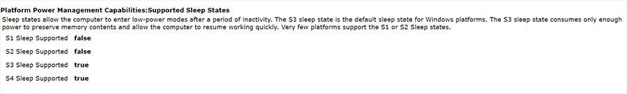

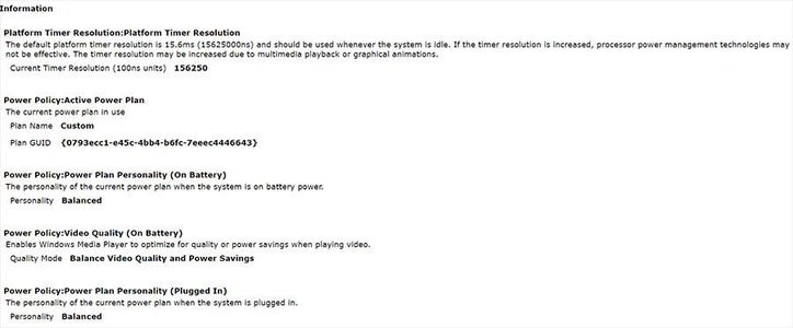

If some app doesn't run properly or the wifi intermittently stops working you need to delve deep into the power management system. Again this utility comes in handy. Type :
powercfg/ENERGY
and the utility will churn out an energy report which can identify how your Windows is configured to utilize the available power. In one case, the random Wifi issue was traced to a wrong power configuration in which the system reduced the Wifi radio power after some period of inactivity.
