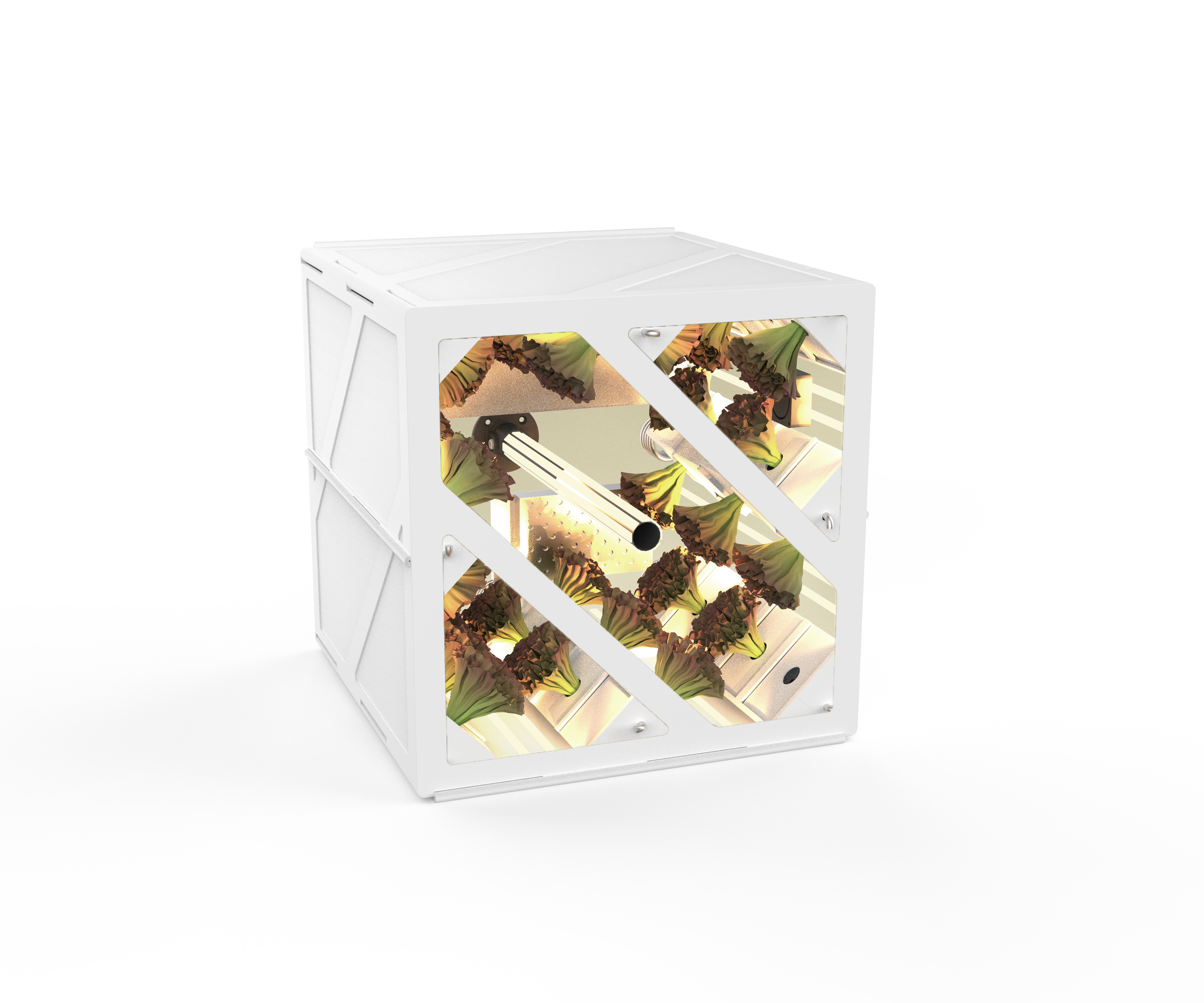

Our proposal is a two-sided checkerboard of root modules, suspended in the center of the shell, with lights, electronics and reservoirs on the “upper” and “lower” outer sides. The driving factor behind this design is to take advantage of microgravity and have plants growing “up” and “down” in relation to each other. This gives each plant space to grow while more effectively using the volume of the center plane. Keeping the root volumes within the same plane instead of stacked on top of each other means we can fit light sources for both sides and keep them at a close, but plausible distance away from the leaf canopy of fully matured plants. The entire checkerboard is held on slides so that it can be pulled out of the shell like a drawer for easy access to the plants.

Since the purpose of this write-up is to specify the “form, fit, and function” of the major components, we do not include detailed construction methodology in this write-up. In our prototype, we sometimes used screws for ease, but we assume that all fasteners can be replaced with bolts paired with threaded inserts as captive nuts.
Step 1: Design & Planning
Based on the research that LED lights should be at least 4 inches (~10 centimeters) away from the leaf canopy to avoid tip burn (necrotic tissue on the lettuce leaves), we did not think there was room within the 50 centimeter cube to fit two trays of growth medium. However, we realized that by interweaving the two trays into a single bi-directional tray, we could fit two layers of lettuce plants with two light sources within the given space (see diagram). This interweaving also meant we could densely nest the modules that house the roots, while still giving the lettuce leaves room to stretch out and grow without too much collision. The attached video above shows the modeling for lettuce growth from planting to first maturity. The green circles represent lettuce growing on the "up" side and the blue circles represent lettuce growing on the "down" side.

- Construct the shell walls. We routed the walls out of a plastic composite and 3D printed the corner joints.
- Install threaded inserts into the walls.
- Assemble the shell.
- Install slides.
- Cut the LEDs to length, add connectors and install them on the walls. Our LED strips have an adhesive backing.
Notes
The shell is designed to fold and flat-pack. See the renderfor how constructing the shell with hinges would allow the shell to collapse. However, due to our limited machining capabilities and time, our prototype uses a rigid shell with plastic walls joined together by 3D-printed corners. To make assembly in orbit as easy as possible, we designed the shell so that some features are installed on the ground, including the slides and the LEDs onto the walls.
Drawer slides are bulky for the tight space constraints. We used a simple square extrusion that slides within a dado in the sides of the growth tray. It is important that the tray and the slide are low-friction so that they slide smoothly and easily.
