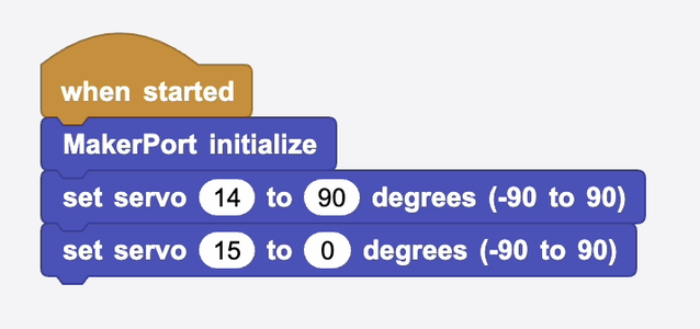

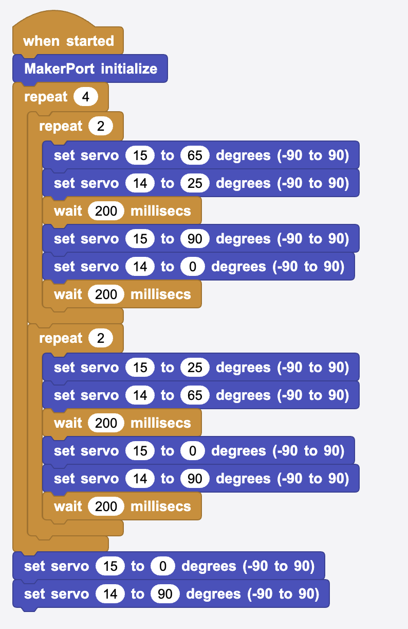

Before inserting the arms on the servos, it will save you a lot of time if you code the servos to be in the initial position you want them.
First, connect the servos to the MakerPort. The arm on the left when you see the panda from the front will be Servo 1, which is the top connection where it says Servos, taking care to line up the ground (black or brown) wire with the G. The arm on the right will be Servo 2, which is the bottom connection.
Since I used a MakerPort, the coding is done with Microblocks. For this step, we just need to code the servos to be in the correct positions. The MakerPort has a switch on the side to let you code it, make sure it is on that setting, then go to the website, go to Browser -> Run, connect to the MakerPort (make sure it is plugged into your device). Connecting to the MakerPort will automatically add the special blocks for the device, but you also need to Add Library -> Servos.
The code is simple (I have a photo or a video if you need one). You will need a "when started", "Makerport initialize", "set servo 14 to 90 degrees", "set servo 15 to 0 degrees".
You might be wondering why we use servo 14 and 15 instead of servo 1 and 2. That is because the internal pins the servos are connected to correspond to Servo 1 = 14 and Servo 2 = 15.
Hit play, and the motors will go to the correct positions. If it is not working, add a separate power source to the MakerPort.
Now you can connect the arms keeping in mind that the positions we set the servos in are the highest position the arms will be on. Mind the head!
With the arms on and the servos ready. It's time to connect our two layers of the red panda together. Insert the feet of both layers of the panda into the slots of the pieces that were labeled stand (either the ones labeled for just the panda or the task tracker). It is a tight fit. Be gentle. With the task tracker stand, the feet of the panda will NOT be level with the ground.
Add the Pom Poms to the red panda's hands. Depending on the kind of pom pom you've found, you can tape them in place, glue them, or make holes in its hands to push through the material.

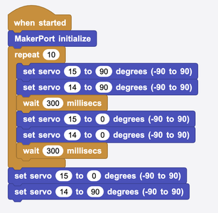

Step 3: Panda - Get Your Cheer On
Now it's time for the red panda to do a bit of a routine. The angles of the arms for the lower positions are Servo 1 (14) = 0 degrees. Servo 2 (15) = 90 degrees. With that in mind, you can code the arms to move within that range at certain time intervals and repeat. You can look at some of the code examples I'm attaching. The most important thing to keep in mind when you want the servos to move is to have the start position and the end position separated by a wait so the servo actually has time to get to the position you want.
Try some of the routines or make your own. Doesn't he look cute?
Make sure you download the code you created onto your computer for coding later as it does not automatically save to it.

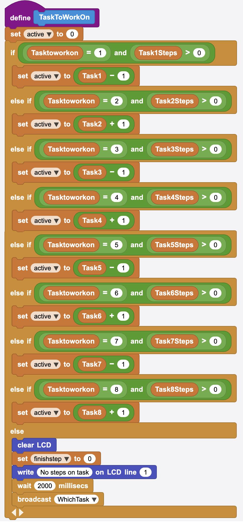

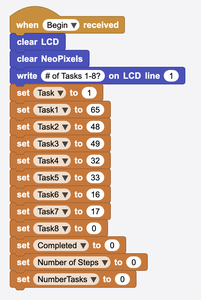

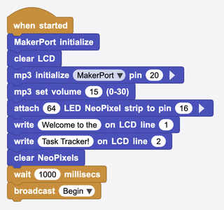

Step 6: Download the Code*
Attached you will find the code I made for the task tracker. Download it to your computer, open it on MicroBlocks, then connect to your MakerPort and hit Play.
*Microblocks' file extension is not supported by Instructables, so I am attaching screenshots of all the steps. If you are interested in the code, DM me.
Try it out. Are the "buttons" doing what they are supposed to? Is the LCD showing the text correctly? Are LEDs lighting up? If not, check the connections again. Make sure you have an extra power source connected to the MakerPort.

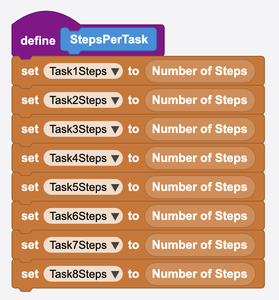

In the next step, I'll go into detail on how the Task Tracker is meant to work. I will not go into step by step on how to code it, but follow the explanation and look at the code provided. Can you figure out how it's working? There are more efficient ways to code it, but I try to keep the code as simple as possible so it can be puzzled out by students.
Step 7: How the Task Tracker Works
The idea of the Task Tracker is that each row of LEDs represents a task and each column a step towards completing that task. You can set the amount of tasks (1-8) and the amount of steps (1-8).
I'm providing a "chart template" that you can put on top of the grid and write by hand what each task and the steps represent, so it can be easy to see what you are working on. Remember those little "L-shaped" pieces from before? I glued them onto the scored markings and they will help keep the paper in place.

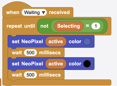

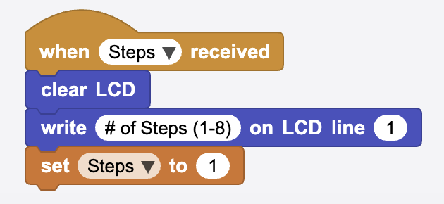

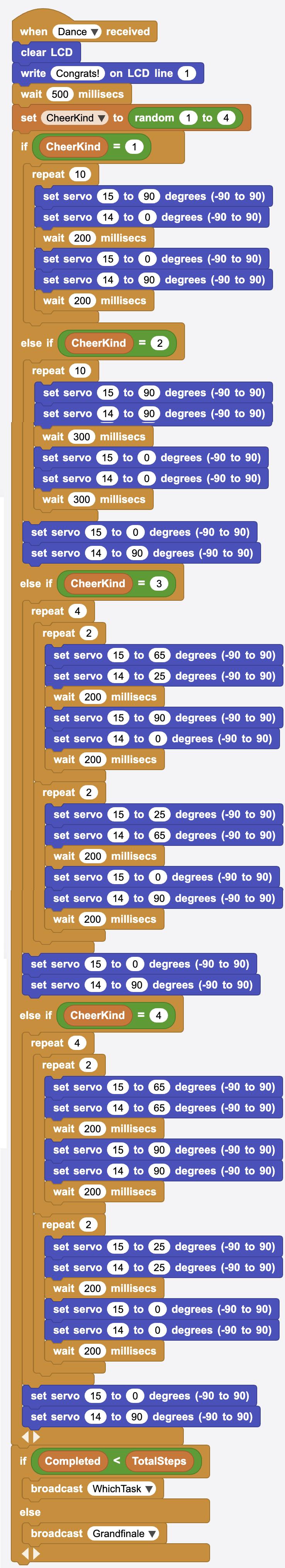

When you turn on the assistant, it'll ask for the number of tasks (8 max) and the number of steps for each task (8 max). Once that is set, it'll ask which task you want to work on (by using the face template it will be easier to see what each row is representing), which will start blinking, and then ask whether you finished a step for that task.

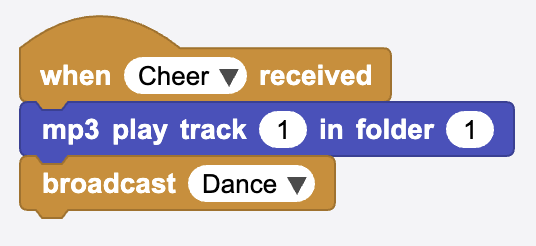

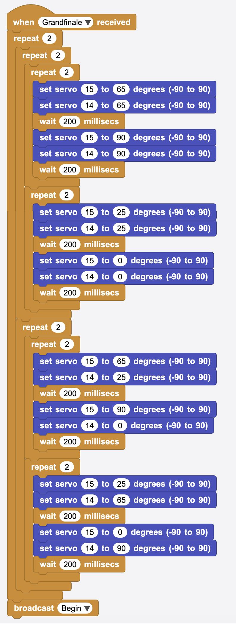

If you say yes, it'll keep that LED on and the red panda does a cheer routine with sound (I used a sound found on Pixabay), then go back to asking which task you are working on, and so on.
So, for an example of how to use it I'll use my own planned usage: say you want to create a comic book that has several pages. You can make 8 pages at a time (# of Tasks = 8). Each page you need to make has to be planned, sketched, inked, and colored (# of Steps = 4). Let's say you are working on page 4 (Which task do you want to work on? = 4). You already finished planning it, so when asked "Finished a step?", you select 1 to say Yes. The LED on that Task/step will light up and the red panda will cheer. You will find him so cute that you just have to see it again. But you need to work on your comic book pages and finish your next step first! ;)
The more tasks/steps you finish, the more lights will turn on. When you are done planning, sketching, inking, and coloring each of the 8 pages, there will be a celebration and then it will go back to the beginning where you can set a new number of tasks and steps for your next project.
