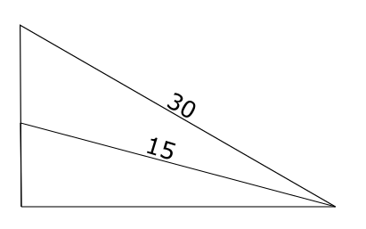

An ideal door stop should be between 15 to 30 degrees.
- Print out the template (see attached image) and cut out the desired angle (somewhere between the 15 and 30 degree lines)
- Stick the template on the side of the wood
- Cut to desired length (adding a few mm extra due to sanding back the weathered surface)
- You will most definately need to slice your wood length wise as a standard piece of wood will be about 2 to 3 times the required thickness
- Cut desired wedge angle
