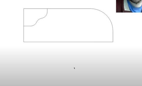

Step 1:
I draw the profile I need and figure out spacing and size

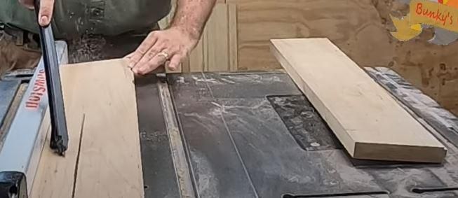

Cut wood into the dimensions of the frame

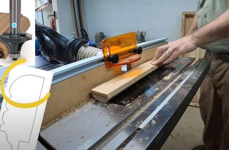

Step 3:

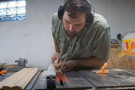

With a router table, use a roman bit and a round-over bit to shape the frame. Using a table saw to make small groves in the frame.

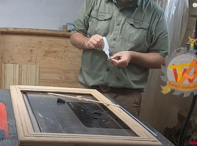

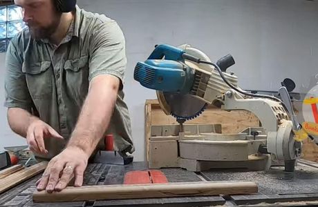

Step 4:

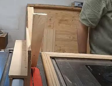

Using a miter saw, make miter butt joints for the frame. Using a spline jig with the table saw cut splines in but joints. add splines and glue.

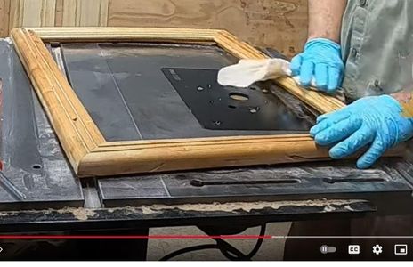

Step 5:
Add the poly of your choice. We used a tung oil finish.

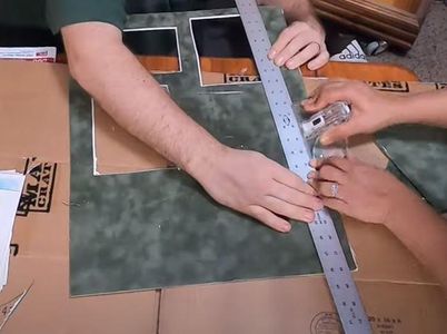

Step 6:

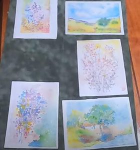

Using a ruler and a matboard cutter, measure and cut the mat board to the size of the paintings and place it in the frame
