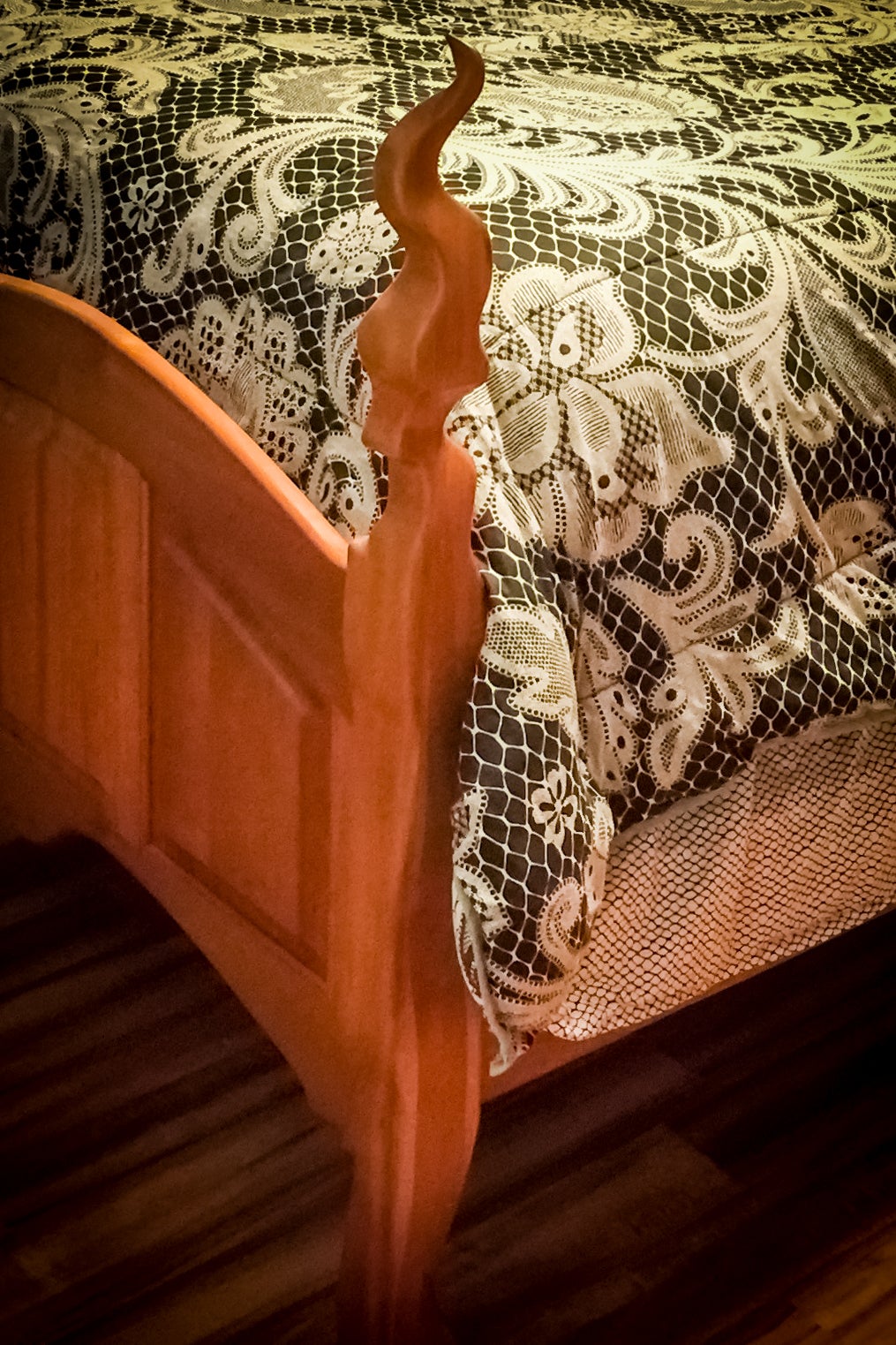

Step 7: Make Your Bedposts
I glued up four 3/4" boards to get the total thickness of 3"x3" for my bedposts. I then mortised the headboard and footboard rails into their respective places and dry fit them. I then drew my wavy design on to two of the sides of each post to show my finish profile. I then cut all the curves on one surface on the band saw. I then tacked a couple of the larger pieces on the back side back on to allow me to cut the perpendicular surfaces. .
The next part was the most time consuming of the whole project. Sanding the posts. You can use a combination of beltsanders and random orbit palm sanders on this but it takes forever with all the curves.
I also carved one of the tops of the bedpost to hold a candle.
