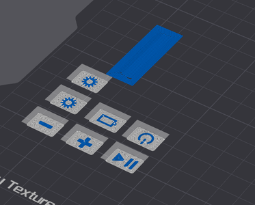

Step 4: Print Buttons
If you have a multimaterial printer you can directly print them. No worries if you don't, I don't either. Without moving the buttons, delete all the white parts (the button itself). DON'T SAVE the project now. Print only the symbols and leave them on the plate. Then undo all the deletes and delete the symbols instead. Change the filament and print the buttons.
Tips for the once not using the .3mf:
Just add all the buttons and make sure the first layer is 0.2mm. Then print as described above.
PS. Taste_2 is the correct shape with no symbols if you want to create your own icons.

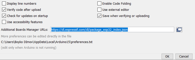

Step 6: Flashing the Esp32
For those that haven't yet flashed an ESP the easiest way is using Arduino IDE.
You need to connect your esp32 to the PC using a USB cable. Check in device manager if the board is recognized. Mine shows Silicon labs CP210x usb to uart (COM X). X here is a number of the com port. Remember that.
Download and install Arduino IDE. When you open it got to File>Preferences and find a field named Additional Boards Manager URL and add https://dl.espressif.com/dl/package_esp32_index.json .
Then go to Tools>Board>Boards Manager and search for esp32 by Espressif Systems.
Once you have installed the module you can go to Tools>Board and select ESP32 Dev Module
The last step is to install 1 library that is used for controlling the screens. Go to Tools>Manage Libraries and search for TM1637. Install the one from Avishay Orpazas seen in the picture.
Finally you are ready to install the code onto the board! To do so click the arrow to the right just below edit that says upload and you are done.

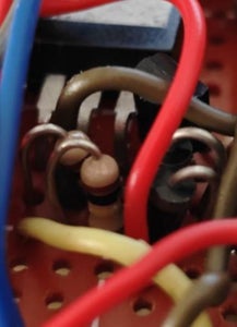

Step 15: Making the Extension Board
We are almost there but this is probably the biggest task. Soldering everything on to the perfboard.
The first picture show the logic of the circuit. In a nutshell the batteries are boosted to 5v to power the ESP and the displays. The P-MOS disconnects the booster from the rest so there is no power draw when the device is off. The power button turns the MOSFET on and the ESP powers the NPN transistor to keep it self on regardless of the button. The ESP can also detect if the power button is pressed and upon holding it, power itself off.
The second picture shows how the resistors and diodes should be placed to save space.
The last is the most important one. It shows the layout and how everything is connected. The borders are separations and the red connections are connected to the other red square with the same number. Only the 2 1M ohm resistors should be laid flat on the board as the will end up under the booster. So make sure to solder them before the booster.

Step 17: Clean the Extension Board and Checking It
Use a toothbrush and 99% alcohol to clean the board, as left over flux can cause shorts. Using a multimeter, check if some of your solders are touching and fix them if it is the case.
